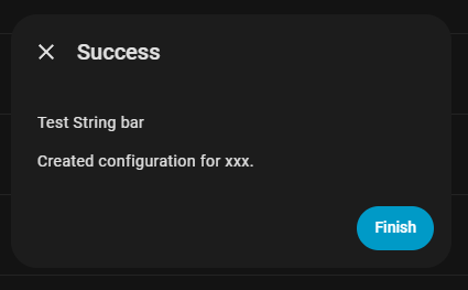

Did a little digging and it looks like description is for adding an extra sentence here:
“Created configuration for” is hardcoded in the frontend and can’t be overwritten, but you can add an additional message (where it says Test String).
            return self.async_create_entry(
                data=user_input,
                title=title,
                description="add_sensor",
                description_placeholders={"foo": "bar"},
strings.json:
  "config": {
    "create_entry": {
      "add_sensor": "Test String {foo}"
Aaahhh. So ‘description’ actually specifies the en.json entry to read, not the actual text of what I wanted to put in it!
That’s great, thanks very much Karwosts
