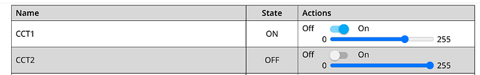

So what you see in web server?
Only Brightness:
