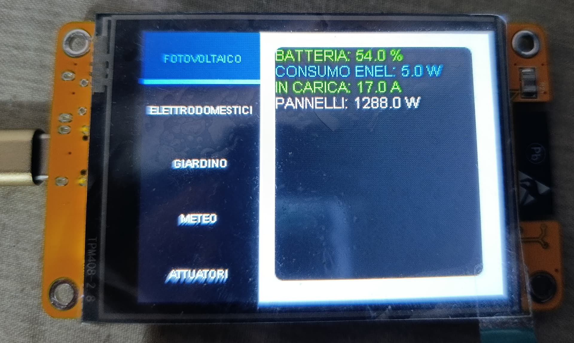

Good morning everyone, I was given 2 yellow chip CYD touch displays and for a few days I have been trying to set up the various pages.
As you can see from the photo I have 5 pages and to the right of it the reference page opens. I am not able to eliminate that annoying white border that I could use that space to make the page a little bigger.
I try to use
disp_bg_color: 0x000000
bg_color: 0x000000
border_color: 0x000000
Can you help me understand what I am doing wrong? I am using LVGL
thanks

Is that correct? 105%
hi, no the value 105 refers to the width px of the selection menu tab on the left. If resize this value change the width.
I just wanted to remove that white border and I only now notice that the page has curved corners instead of 90 degrees
I’m not a display guy… Documentation gives % for tabview size option.
  • size (Optional, percentage): The height (in case of TOP, BOTTOM) or width (in case of LEFT, RIGHT) tab buttons. Defaults to 10%.
But your code looks different from docs anyway…
I tried to rewrite the tabview from scratch.
I think I solved it by trying to put the bg_color: before tabstyle
widgets:
  - tabview:
      position: LV_DIR_LEFT
      bg_color: 0x000000
      width: 320
      height: 240
      tab_style:
