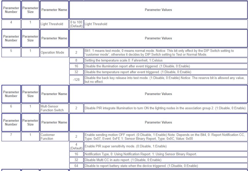

according to device documentation see here
it seems to be related to parameter 7, but I need your help to understand what are correct settings to get off state after some time of “no motion detected” (may be i just need to set it to “2” ?)

You have two approaches, but I think best one is set parameter 7 to “22”.
set it in HA zwave control panel then wake up your sensor (press 4 times front or back button in 2 seconds) and wait some minutes
then refresh the node, amd wake up it again.
restart HA
