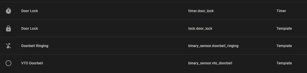

I have now this completly code:
# VT0
sensor:
  - platform: dahua_vto
    host: xxx.xxx.xxx.xxx
    username: XXXX
    password: XXXX
    scan_interval: 5
timer:
  door_lock:
    icon: mdi:timer
lock:
  - platform: template
    value_template: "{{ not is_state('timer.door_lock', 'active') }}"
    optimistic: false
    lock:
    unlock:
      - service: dahua_vto.open_door
        data_template:
          entity_id: sensor.dahua_vto
          channel: 1
          short_number: HA
template:
  - trigger:
      platform: event
      event_type: dahua_vto
      event_data:
        Code: BackKeyLight
    binary_sensor:
      - name: Doorbell Ringing
        unique_id: doorbell_ringing
        device_class: sound
        auto_off: 00:01:00
        state: "{{ iif(trigger.event.data.Data.State | int in [1, 2], 'on', iif(trigger.event.data.Data.State | int == 0, 'off', states(this.entity_id))) }}"
  - trigger:
      - platform: event
        event_data:
          Code: BackKeyLight
    binary_sensor:
      - name: VTO Doorbell
        auto_off: 00:01:00
        state: "{{ trigger.event.data.Data.State | int in [1, 2] }}"
Door is working perfectly and I have these entitys now:
Doorbell cannot be tested today, baby is sleeping. :smiley: But I will comeback tomorrow.
I hope this is fine now.
Great! Doorbell Ringing and VTO Doorbell it’s a same sensors, test it and keep one which looks better for you.
