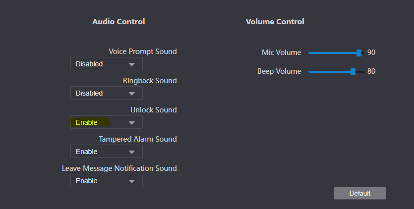

Hello. Thank you for the integration. Question: I have a VTO2111D and when I open the door from the DMSS app the intercom also plays a sound “the door is unlocked”. However, when I use the open_door action the door unlocks without any sound played. I tried
action: dahua_vto.send_command
  entity_id: sensor.dahua_vto
  method: console.runCmd
  params: {'command': 'ps 0'}
  event: false
but no sound is played at all. Also tried 1/2/3/…
Tried help console command but no result seen in the event viewer
  params:
    command: help
  event: false
Are my console commands ignored? Or is the ps console command only for VTH?
Any thoughts?
My VTO2111D (2020-03-11 V4.300.0000000.7.R) plays message The door is alarmed if door is opened from integration or DMSS application only if Unlock Sound enabled in Web UI:
