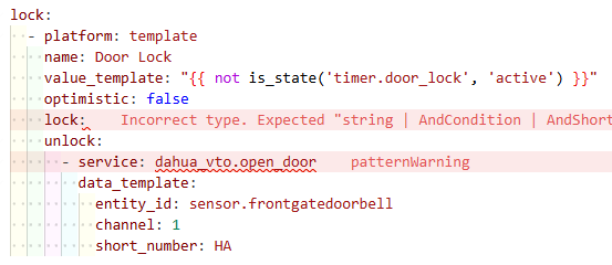

Having an issue since recent update.. completely broke the unlock functionality.. getting the following error:
template:
  - lock:
    - name: closing gate
      optimistic: false
      state: "{{ not is_state('timer.door_lock', 'active') }}"
      lock: #is optional but without it ha throw an error
      - data_template:
          entity_id: sensor.dahua_vto_gate
          channel: 1
          short_number: HA
        action: dahua_vto.open_door
      unlock: #unlock - opens gate lock
      - data_template:
          channel: 1
          short_number: HA
