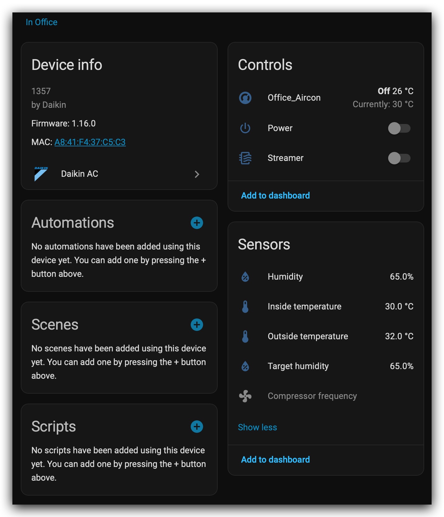

I have 4 Daikin AC . 3 of them appears as model 1357 and 1 as 135A under the Daikin integration.
While 2 of the 1357 has 13 entities, 1 of them only has 8. I’ve checked that the model of the AC is the same for all 3.

For my case, 2 of my other AC already have the full set of entities while a 3rd of the same model has less. Just need a way to expose the 5 that is somehow not there.
For entities to exist in HA, the device and any interface hardware needs to expose them.
My guess is one of your installs is not like the other, hence what you see as missing.
