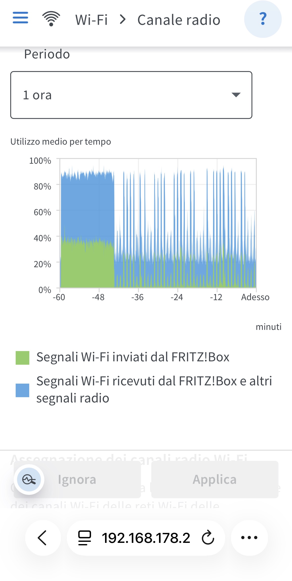

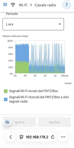

I had the same problem with my units. Accidentally I updated one from 2_0_0 to 2_3_0 and my home network literally crashed. It took me a while to understand that the Daikin units were responsible for this disaster. This is my wifi band before and after turning manually off the dailkin unit with 2_3_0 . Crazy.Wrote to the daikin assistance and told me to wait for an update. Can anyone tell me how to activate the Onecta on Testflight and try 2.6.1 ? cannot find the way. Thx
