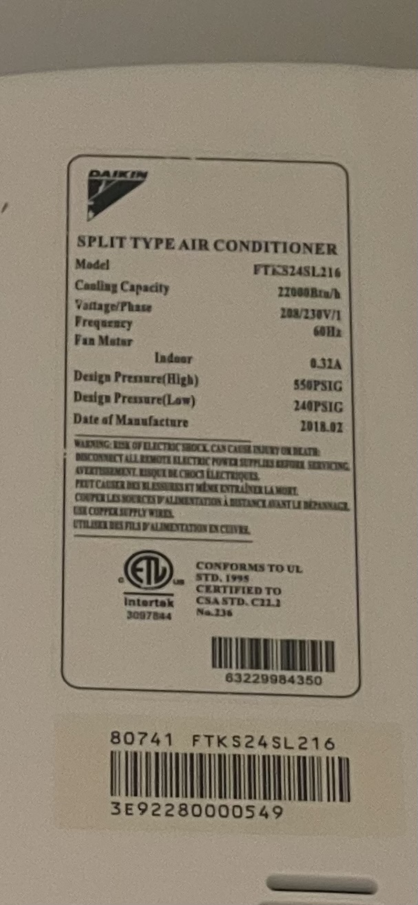

yes. it clearly is a Gree board they put inside Daikine labeled AC. Funny, maybe because LatAm, so they can get away with it?
I will try to put esphome gree adapter, just waiting for the Logical Bridge (5–>3.3) adapter.
So it’s some imitation of Daikin?
Labeled Daikin, sold as Daikin. ¯_(ツ)_/¯ With the appropriate premium label price :slight_smile:
You called it Daikine.

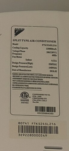

What’s the exact model of you Daikin?
What’s the model number? In some places the daikin is rebadge as acson and just the same motherboard with s21 or cnwir ports
sorry for the quality, will take a better picture of the label tomorrow, once I get the :ladder:
So quick research shows that it’s a “genuine” model for specific market area.

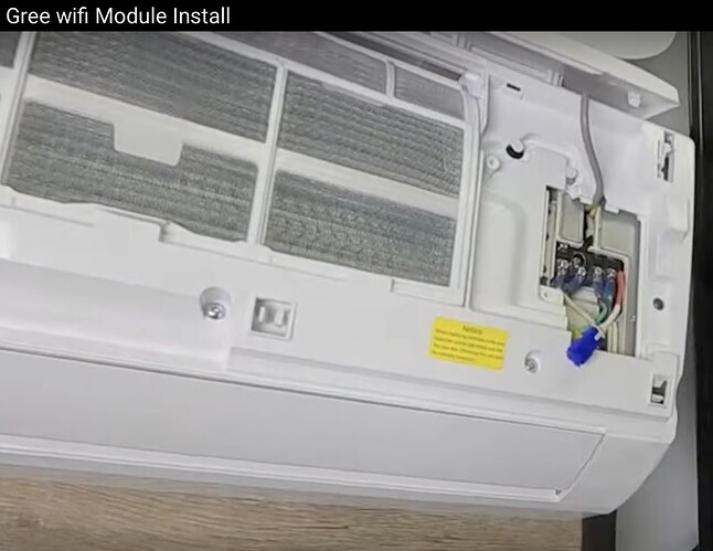

Do you have wifi module on board?
No onboard module.
Just the cable connector routed to where it should go.
I will put an esp32 gree wifi adapter together in next 2-3
days, and report back.
And yes, the units are sold as Daikin, with price premium compared to any other units like LG or Panasonic.
The original gree wifi is cloudbased, dont want that.
Confirmed.
The AC, although labeled Daikin and sold as Daikin, is Gree (called it Glee before) ¯_(ツ)_/¯
The WiFi adapter based on esp32 and esphome from the link below is working perfectly -

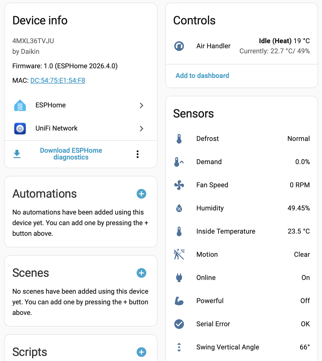

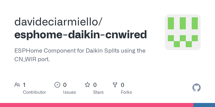

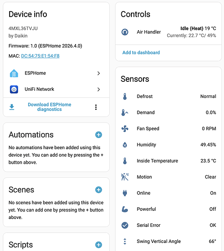

Hi. I have converted faikout to esphome.
This is the repo
