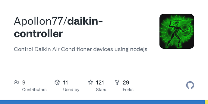

Found some old repos but seems they might no be maintained for previous models:
