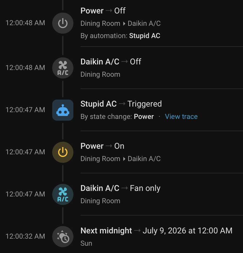

I have a Daikin BRP15B61 which is working great with the Daikin integration, apart from one little issue. A few times a week it is turning ON the A/C at midnight! I was only using the integration to manually drive the A/C as I have timers set in the A/C unit itself (they run from 0530-0700 everyday). The first couple of times I woke up at 2am or something and thought I'd somehow turned it on earlier and forgot to turn it off, but when I looked I could see in the Activity log it was turning on by itself...
No idea why on some nights it's turning on the A/C at midnight, and I've had to create an automation that looks for the A/C turning on between 0000-0500 and then turns it OFF!

If the activity log does not show who/what turned it on, (only shows “turned on” for example) you can assume that it’s coming from outside HA.
OK, that’s interesting. I’m relatively new to HA.. this is all Activity shows.. Obviously “Stupid AC” is my automation.. :slight_smile: How do I figure out where it’s being triggered from?
