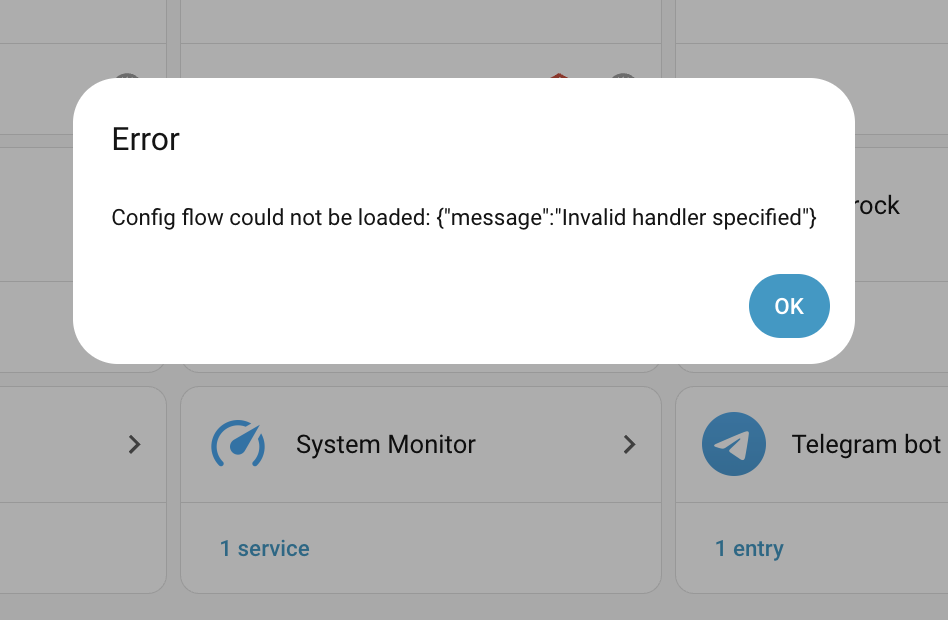

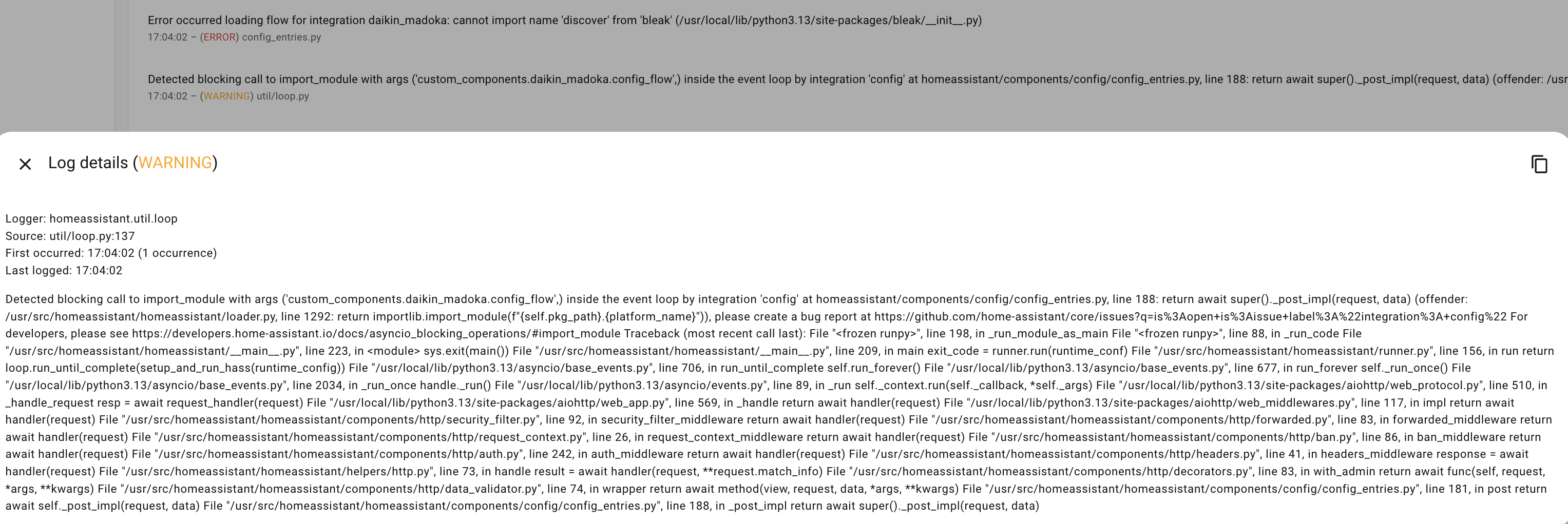

I’m trying to set up the Daikin Madoka integration but am encountering an error during the configuration flow. The integration folder and required dependency have been installed successfully, but I cannot complete the setup.
Describe the bug:
When I go to Settings > Devices & services > Add integration and search for ā€œDaikin Madoka,ā€ clicking on the integration results in the following error message:
Error
Config flow could not be loaded: {ā€œmessageā€:ā€œInvalid handler specifiedā€}
To Reproduce:
Installed the custom component by placing the daikin_madoka folder in /config/custom_components.
successfully paired the Madoka controller to my Home Assistant instance’s built-in Bluetooth adapter.
Installed the pymadoka dependency manually using the SSH & Web Terminal add-on with the following command:
pip install pymadoka==0.2.12 --target /config/custom_components/daikin_madoka/
Restarted Home Assistant.
Went to Settings > Devices & services > Add integration and attempted to add the Daikin Madoka integration.
Expected behavior:
The configuration flow should load, allowing me to enter the necessary details to set up the Madoka controller.
System Information:
Installation Method: Home Assistant OS
Home Assistant Core: 2025.8.0
Home Assistant Supervisor: 2025.07.3
Home Assistant Operating System: 16.0
Frontend: 20250806.0
Additional context:
I have tried several troubleshooting steps, including:
Verifying the folder name (daikin_madoka) and file structure in custom_components.
Confirming the presence of the init.py file.
I tried the steps here for modern #60 also.
Recursively setting file permissions with chmod -R 777 /config/custom_components/daikin_madoka.
Attempting to install the pymadoka dependency via the ha core shell (which did not work on my system). The pip command in the SSH & Web Terminal add-on was the only successful way to install it.
Re-downloading the entire integration from the GitHub repository to ensure file integrity.
The issue persists after all these attempts.
Any help would be appreciated

Trying to setup this integration in HA (not using a proxy) and get the following error when loading the configuration wizard:
Any help would be appreciated!
