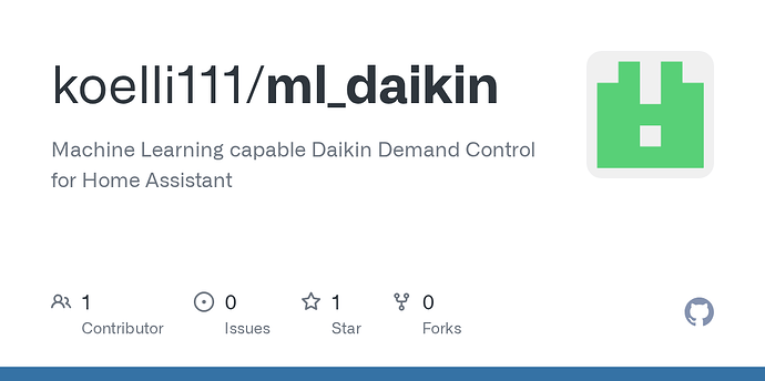

Thanks for sharing this project. I had a look at it and it is very interesting.
I think we are approaching a similar goal from different directions. Your focus seems to be on improving the Daikin behaviour itself, especially for heating, by using local control with Faikout and machine learning.
My current focus is more on the overall room control and the integration of the Daikin units into a larger Home Assistant energy system. For me, the important question is how to achieve the desired room conditions at the right time and under the right overall conditions.
I also use the Daikin units as part of a hybrid heating system together with my existing heating. Therefore, I am currently collecting operational data and analysing the behaviour of the system.
I agree that local control has some interesting advantages, especially because it avoids cloud limitations and provides more direct access to the device.
Your approach is very interesting, especially regarding future analysis and optimization of the device behaviour. I will definitely have a closer look at Faikout.
