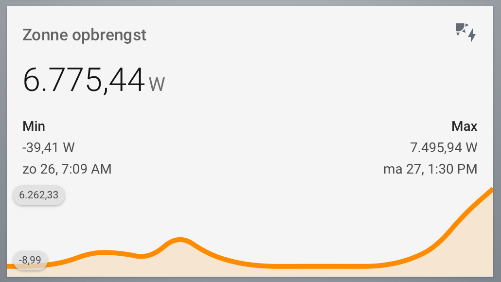

I can do the extrema setting on a custom mini-graph-card, but, other than that, I havent been able to find a solution in core HA

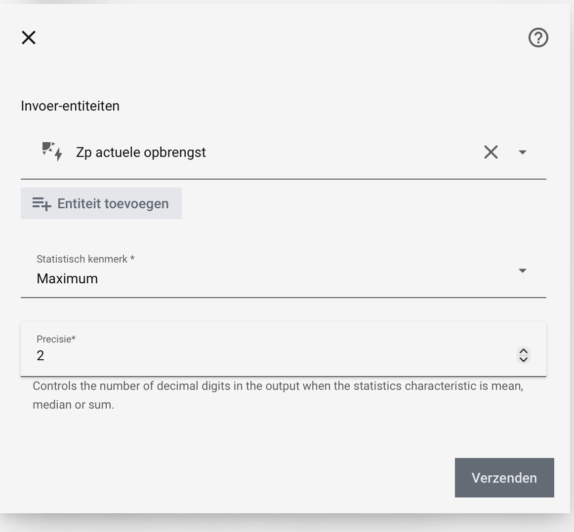

statistics or min/max, the combine helper entities dont do as I need (even the max entity goes down when next measurement is less than a previous max), and utility meter seems not made for the job either

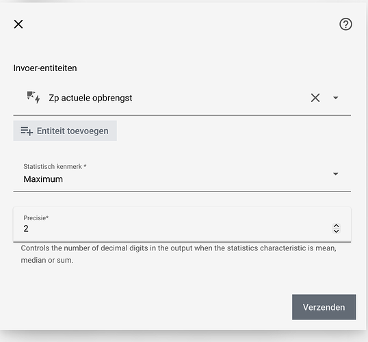

I’ve been made aware of GitHub - jeroenterheerdt/HADailySensor: Sensor for Home Assistant that gets reset at midnight · GitHub, but again, I’d prefer a core solution
seems so simple: based on solar_panels_production, create a solar_panel_production_max
as said , this doesnt cut it.

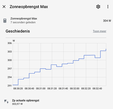

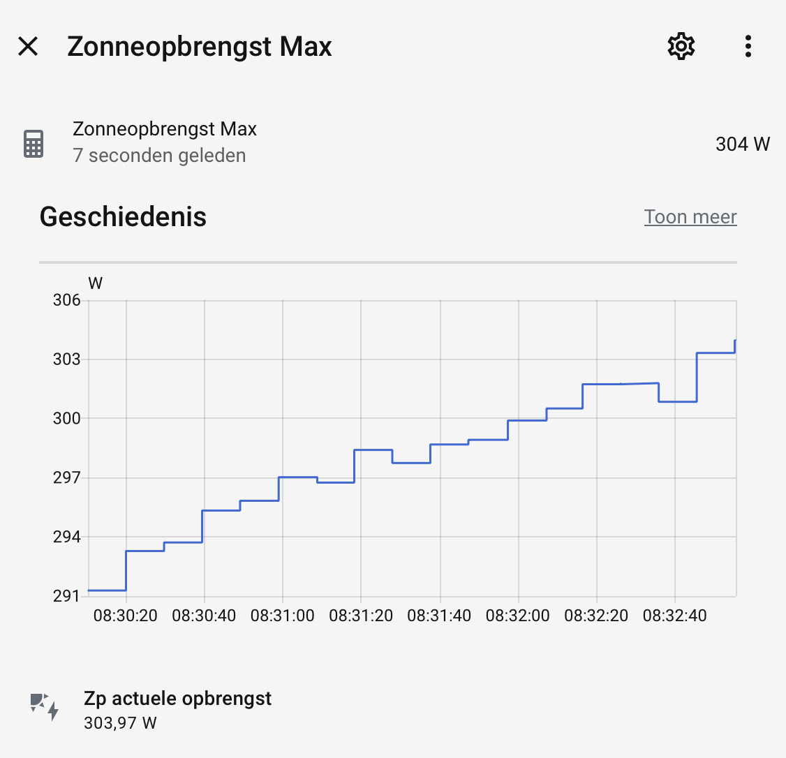

this shows it in the right extrema

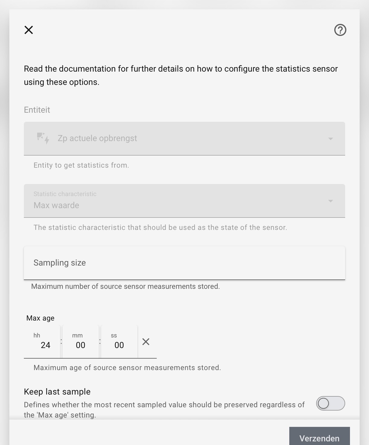

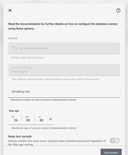

Have you looked at this?
Statistics - Home Assistant
Yes,thx I have that too
Not sure it works yet as I can’t see a history on it
Above the Template below the statistics
The Statistics integration only does rolling max values, there’s no way to limit it to the current day and still have a 24 hour max span.

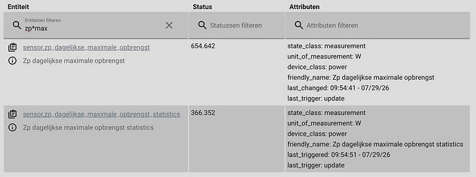

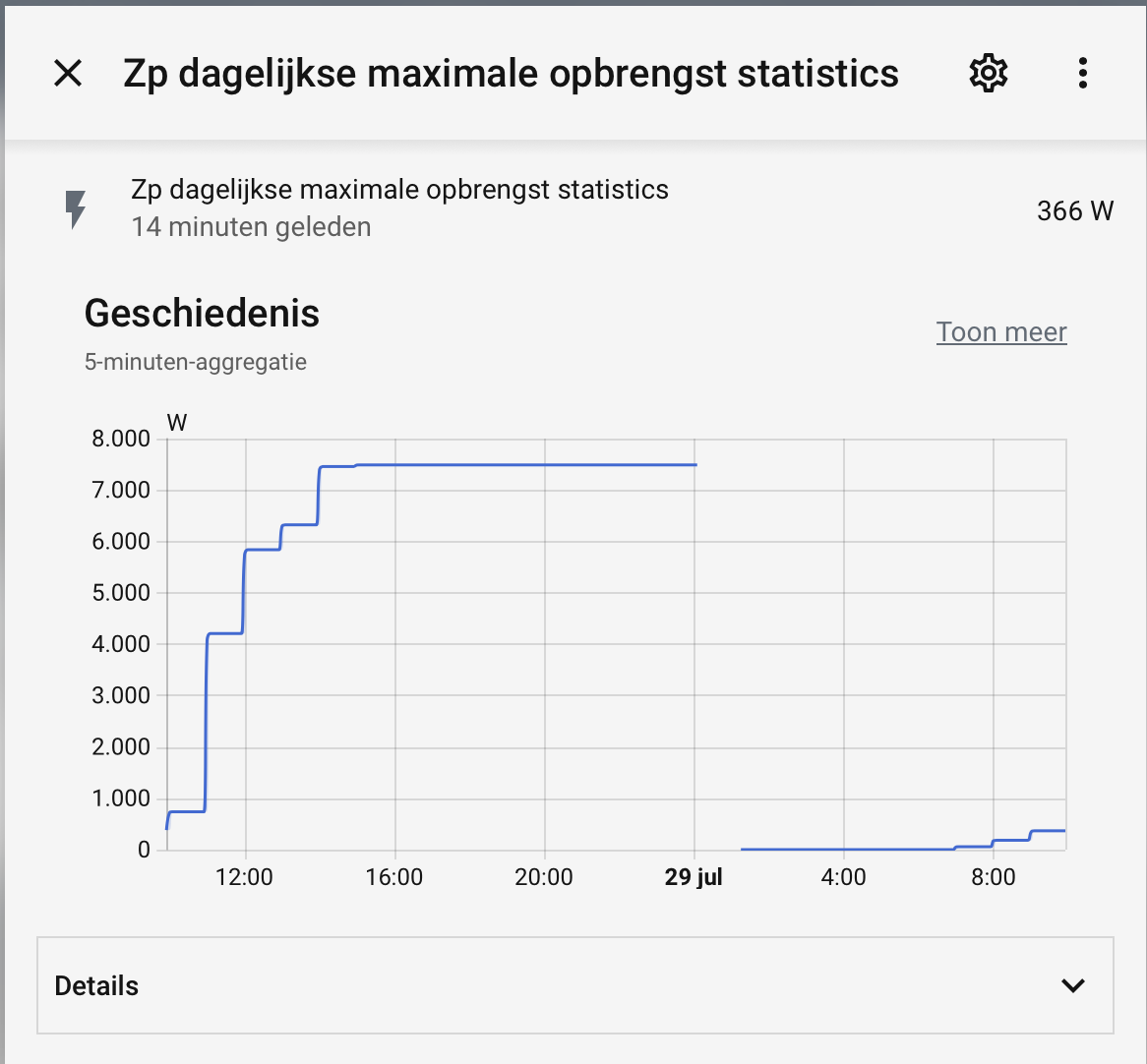

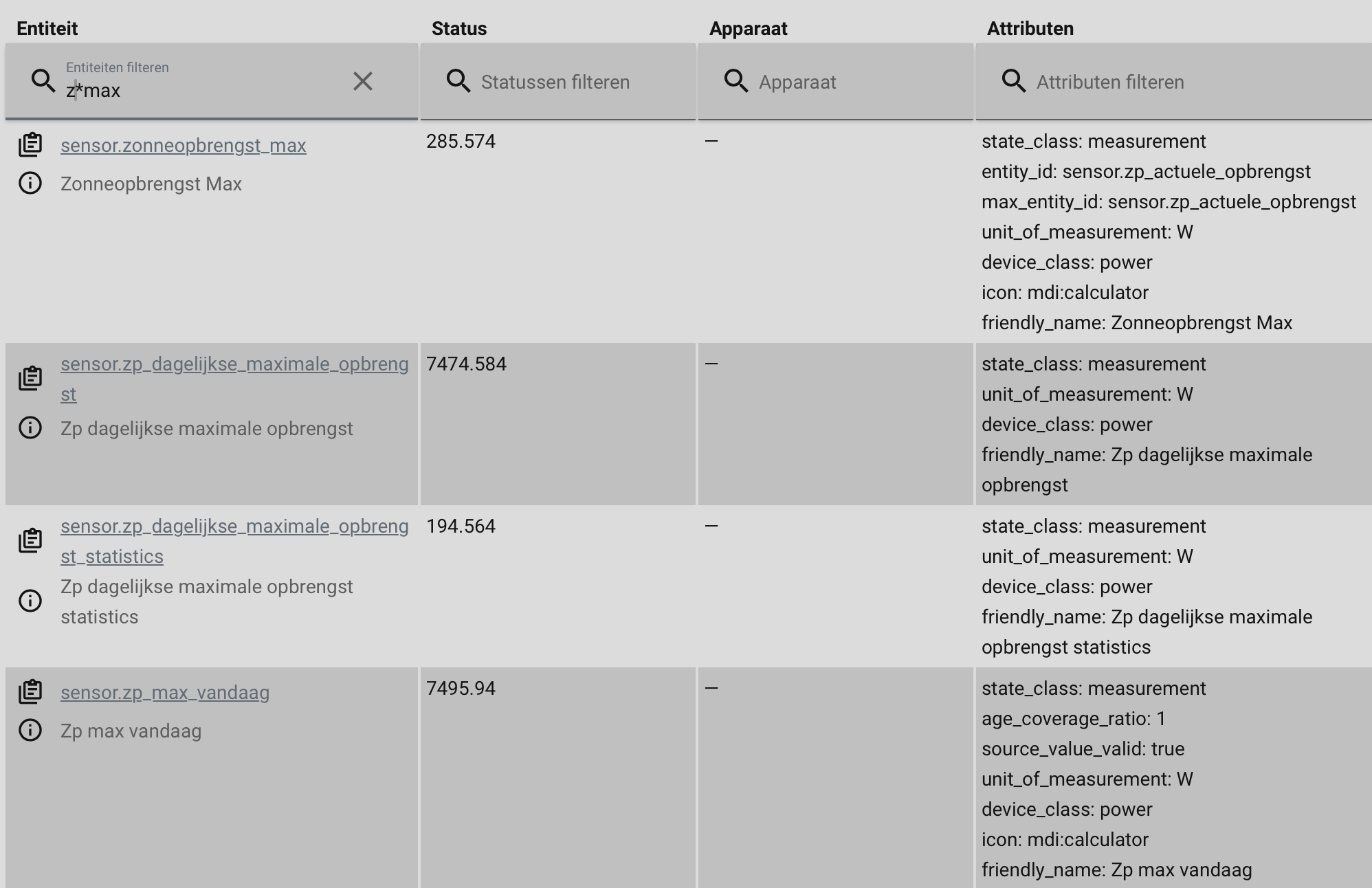

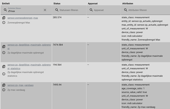

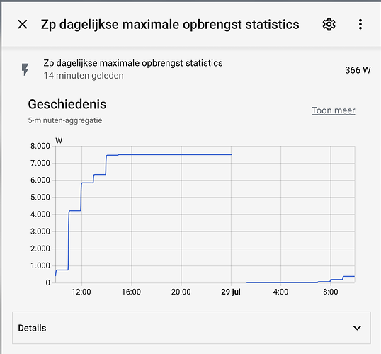

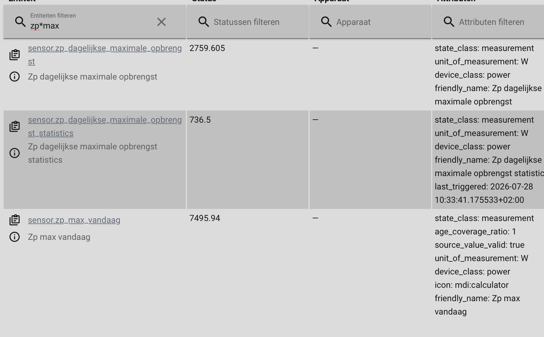

from top to bottom:
  • helper Combined Max: resets and updates continuously, however, Ive also seen it decrease, so apparently not always Max of the day
  • trigger template as per post above, doesnt reset and still showing last days max.
  • trigger template recorder.get_statistics: resets and trigger per 15 min now
  • helper Statistics: doesnt reset and shows yesterdays max
so this probably shows the most robust and efficient solution without having to create a lot of ‘guards’ in triggers or otherwise is the the trigger template using the recorder.get_statistics.
it doesnt need a ‘reset’ trigger, as it does that by design. the update frequency is full controllable.

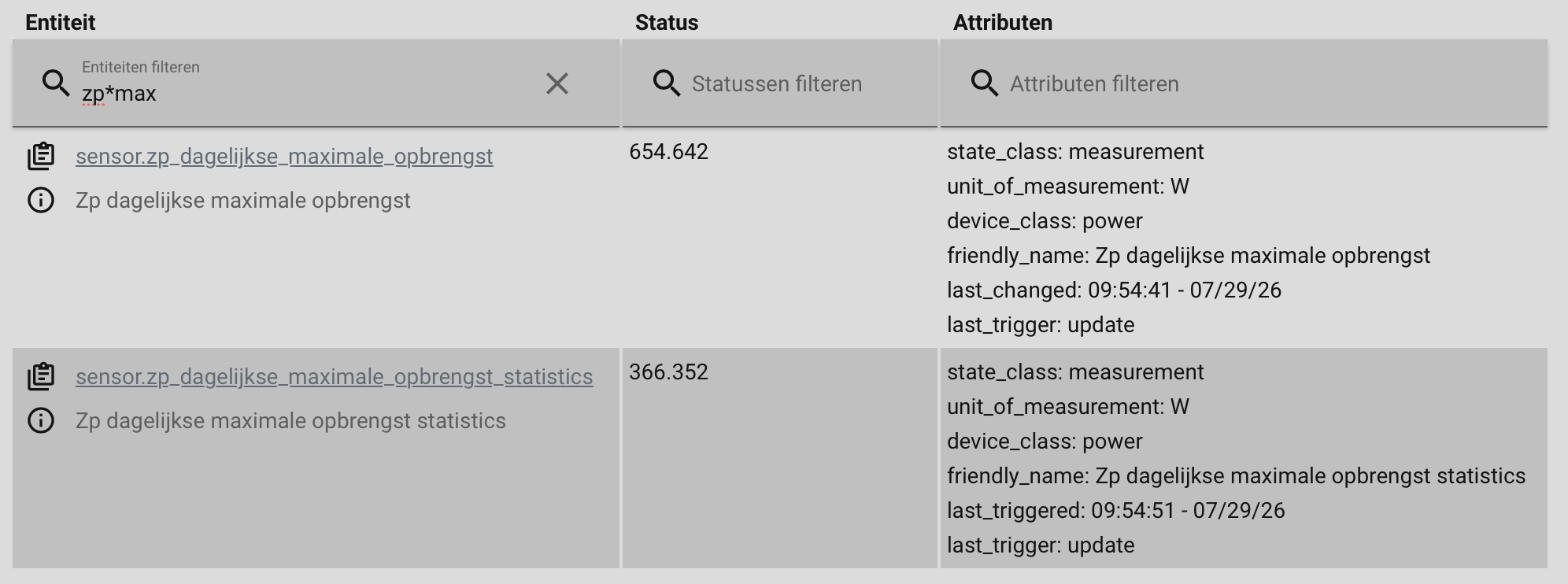

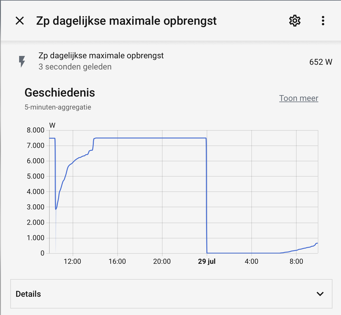

update
the trigger button doesnt work, so I changed to the state: version for that input_button. and added a attributes for last_triggered to be sure it updated.
and what shows: the state doesn’t update, while the attribute does. so my guess now is that the record db isnt updated yes? could that be?
will have to resort to the regular template with nightly reset I guess (the top one in the list here), it updates immediately upon request. the recorder statistics template still lags even though pushed manually
ok, so I deleted the statistics and min/max to leave the regular trigger template, and trigger template with action recorder.get_statistics.
Ive adapted the triggers a bit more, gave all a trigger.id to play with in conditions, and am seeing good behavior now.
correct resetting at midnight, and steady state changes during the day
to be sure it only updates on increase I added a condition template. At first I feared that would only be useful for the action block, and not for the regular sensor, but the documentation clearly states
Define conditions that have to be met after a trigger fires and before any actions are executed or sensor updates are performed (for trigger-based entities only)
so that is great. Otherwise I would have had to take these 2 out of the 1 trigger config…
(also, it seems to not harm that the recorder.get_statistics sensor is triggered by the reset trigger. its own configuration does as much itself, works fine as far as I can see)
the only difference between the 2 now is that the state sensor is more accurate during increase than the statistics version, simply because the DB isnt updated as often and it lags a it because of that.
you can clearly see that in the attributes, where the last triggered shows they are updated at the same time, while state is behind
