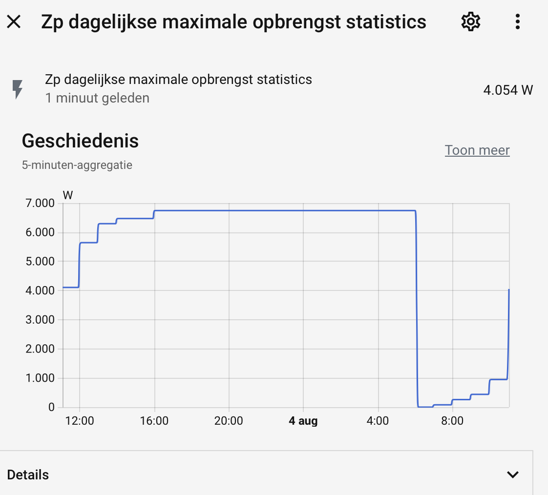

which I did, and statistics is working fine now, albeit with the known delay
but my state template trigger isnt 100%
it was not reset at midnight since a few days apparently… hadn’t noticed during beta

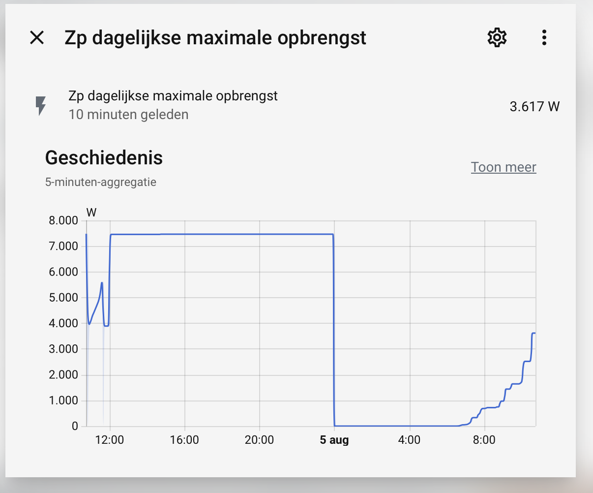

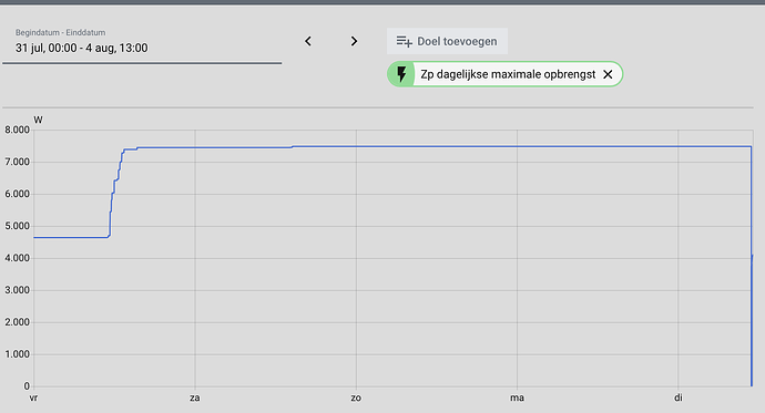

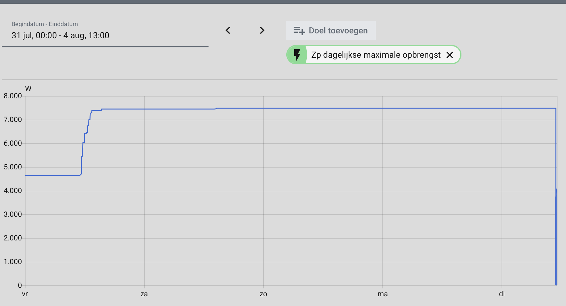

all triggers work correctly, as you can also see in the history now, I rest using the input_button
why wont this reset during the night?

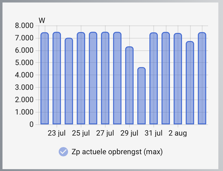

I think I might not be following this thread correctly, but you want to know the max output each day?
Last year I wondered the same – to see if my panels were dirty. And if I could get HA to alert me of that.
I first set up an automation to run right after midnight to get the max from the previous day using recorder.get_statistics as @petro showed above to alert me of that day’s output below some threshold. But then it just alerted about the previous day being cloudy even with me trying to account for that.
Then I set up a simple stats graph which is just the max per day, to look at once in a while:
So, what I came here to say, I finally physcially inspected my panels and they were very dirty. I spent a day cleaning them and, well, almost no change in output. :wink:
