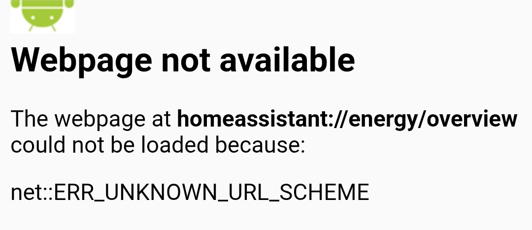

It works as expected/desired from the HA Companion app on my phone. Unfortunately, from a browser (Firefox, Chrome, Edge…) when I click on the badge, a 2nd browser tab opens and is never populated, the url displayed is: about:blank (or homeassistant://navigate/energy/overview )

I tried without “navigate” and got the same “null” result on a desktop browser. I cleared the browser cache, restarted the browser, still no joy.

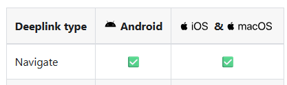

Here’s where I got the instructions on the use of “navigate”: URL Handler | Home Assistant Companion Docs

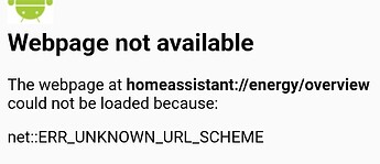

  url_path: homeassistant://energy/overview
interestingly, this breaks what was working from the Companion App:
I restored “navigate”: Companion Apps works, browsers do not.
