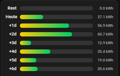

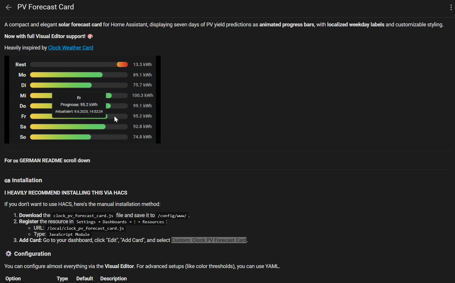

search for “custom:clock-pv-forecast-card”
looks like this
EDIT: the first bar named rest is sort of upside down, means it starts from the right and shows the remaining amount for the actual day … since being after sunset this pic shows nothing :slight_smile:
EDIT2: looks as if it’s named “pv-forecast-card” in HACS
apexcharts with a entity per sensor and offsetting each sensor is sufficient fafaikt…without data_generator
This worked exactly what I was imagining! Nice!
heh, except the tool-tips is DE and not English… oh well, close enough!
perhaps you ask the author … or modify the js file yourself.

Can someone explain how to add clock-pv-forecast-card to a dashboard.
I installed it through HACS, but if I am trying to add it to a Dashboard, it is not listed there.
Thank you in advance

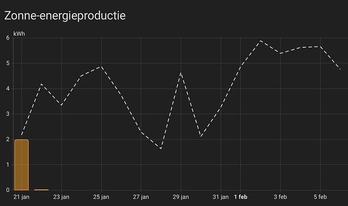

I cannot answer that question. I can tell however that, contrary to what is said above, the energy dashboard is able to tell future predictions if you add the required sensors to the energy dashboard configuration:
which card is that?
i am reffering to this one. As I could see on the top, the discussion was also about this one.
don’t really understand point 3.

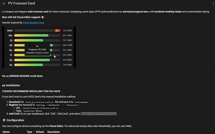

How to do this … and select Custom: Clock PV Forecast Card .
seems to be this one: GitHub - dropqube/pv-forecast-card: A "Clock Weather Card" inspired solar forecast card for visualizing the forecast

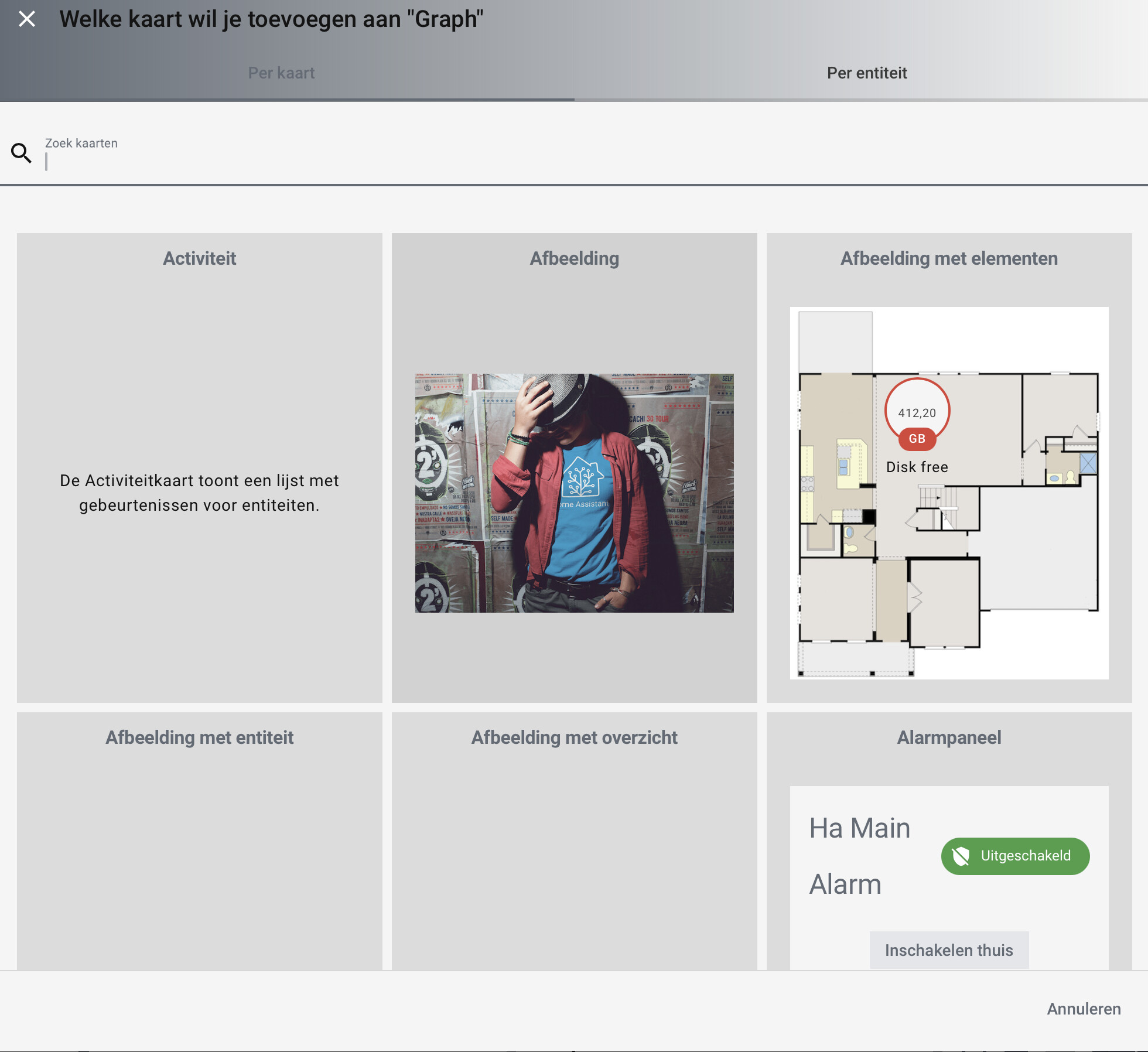

if the card was installed correctly, you should be able to find it in the setup of a new card in the UI. Click add card and get this screen. You can then type the card name in that search box
Yeah, this is the one I am talking about.

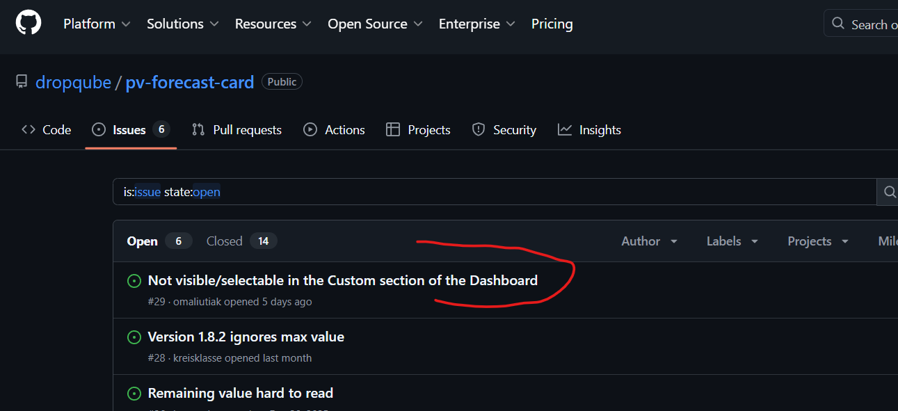

The problem is that after installation through HACS it is not listed while trying to add as a new Card.

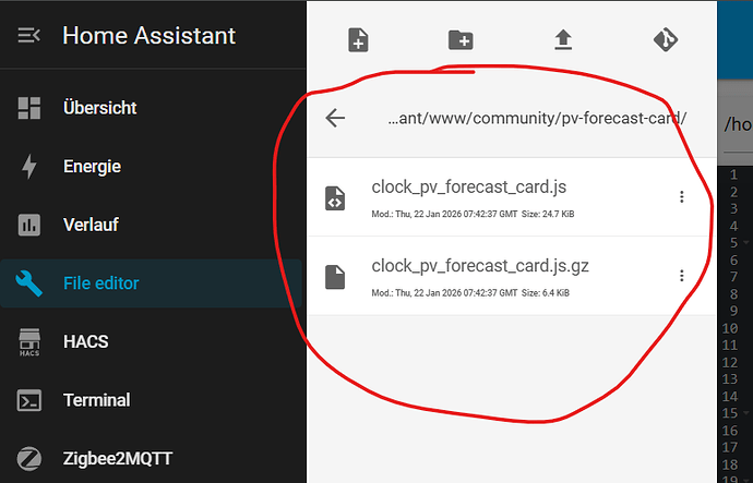

I can see that the files are installed (see screenshot)
you did reload the resources? as per instructions
click top right menu (the 3 dots, in my case the template :wink: ), and select reload resources (Bronnen opnieuw laden)
where can i find this menu? I don’t see it whithin a dashboard

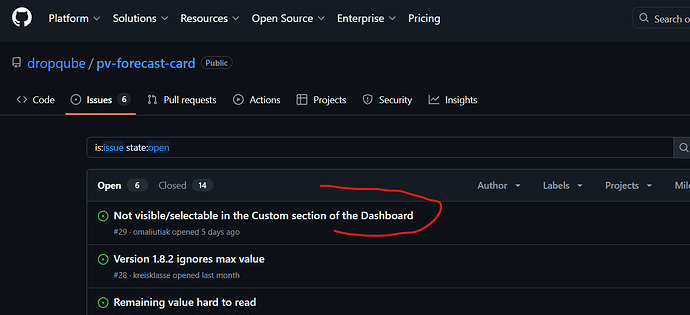

there is no need to discuss about it anymore.
It is reported already as a bug in GitHub. However, thank you for willing to help.
