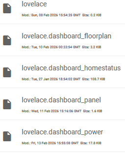

What is the Dashboard file named in .storage ? ,
homeassistant/.storage/lovelace_dashboards
i mend this dashboard
Could it be an issue with the in built android tv 12 web viewer? I use dashboard screensaver to open the url
    "id": "family_calendar",
    "show_in_sidebar": true,
    "icon": "mdi:calendar",
    "title": "Family Calendar",
    "require_admin": false,
    "mode": "storage",
    "url_path": "family-calendar"
Notice the “Naming”
Depending upon creation date etc., this will give you the url either
:8123/dashboard-homestatus/homestatus
OR i.e
:8123/dashboard-homestatus/0
So try to cut the /Home , and just use /0 <<<zero
