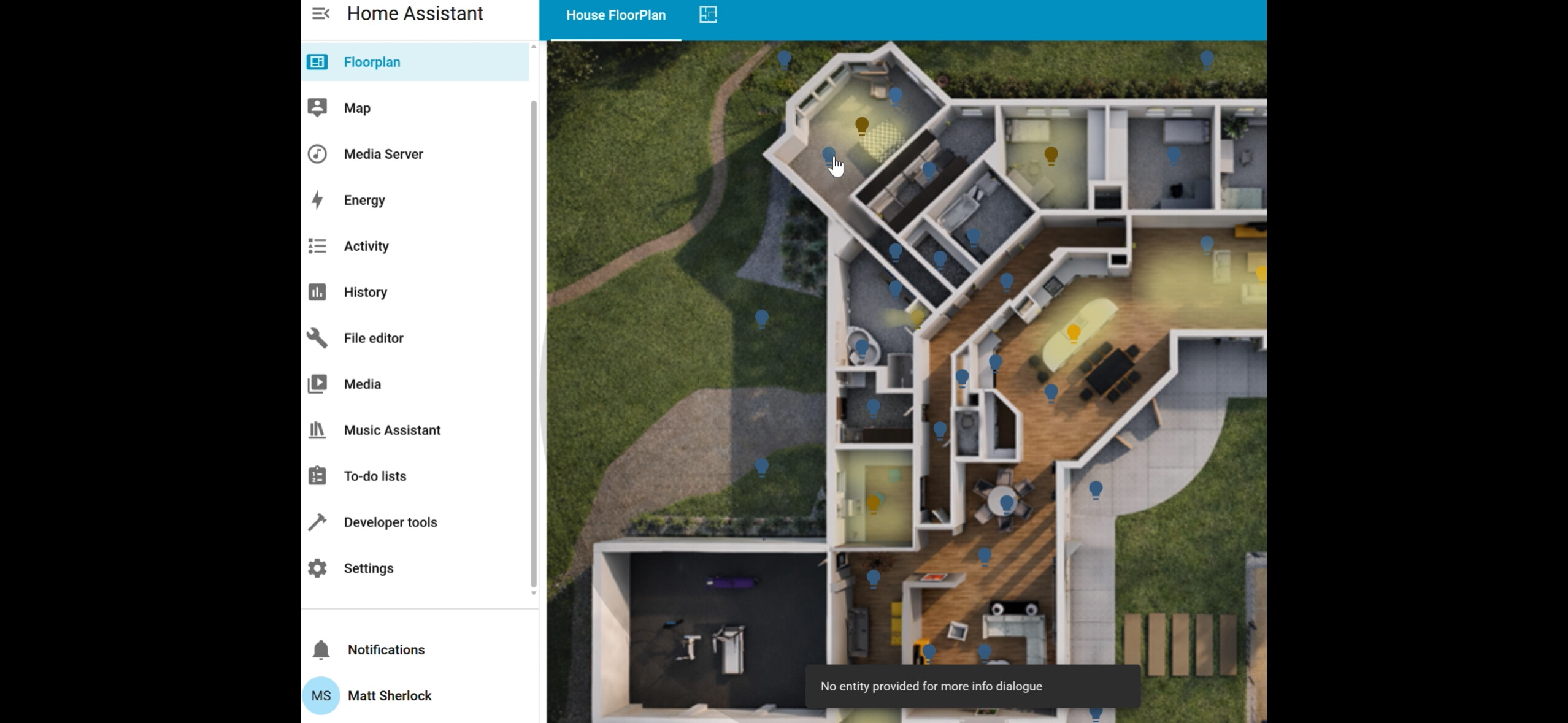

I have started using HA this week, after installing Shelly lighting relays. I have created a floorplan in Photoshop and have created my main floorplan. I am getting an error when I try to turn on consecutive lights -
“No entity provided for more info dialogue”.
Can anyone tell me the cause and solution

Using what?
The core picture elements card or a third party resource?
Share the config for the card. You likely just missed the entity_id option for one of your element actions.

RESOLVED: it was as simple as putting all of the conditional image elements first, followed by all of the state icons. The softwares layers everything so my on state images were covering my buttons, which explained why it got worse when more lights were on🤦🏻♂️
