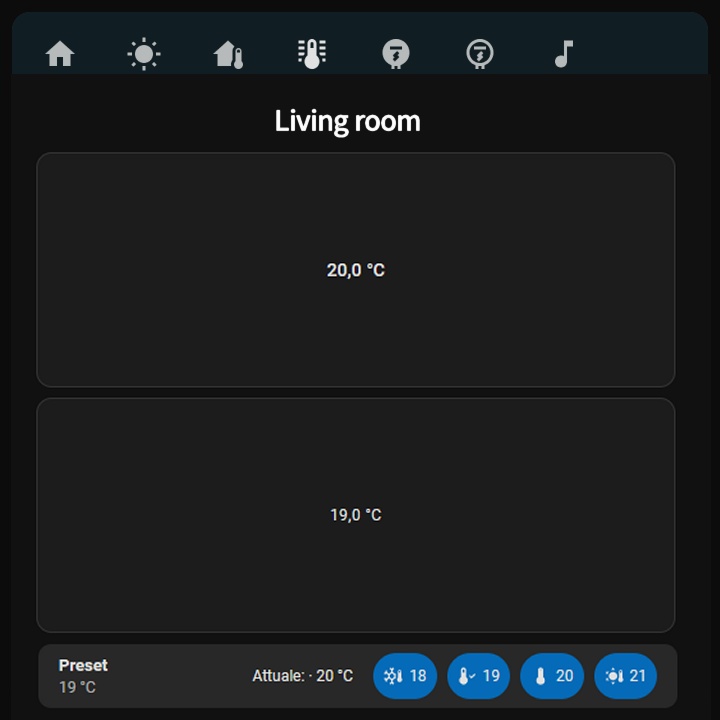

How do I turn this:
into this?
Thanks
Search for “big number card”.
Alternatively you may use a stock Markdown card with custom styling for color and font-size.

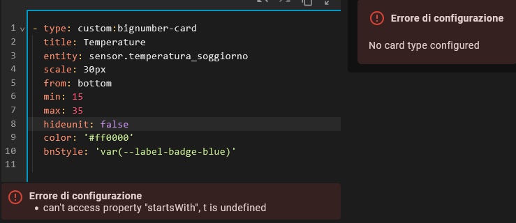

I created a new manual card and pasted the first example code into the YAML editor:
Basic Example with Severity
  • type: custom:bignumber-card
    title: Humidity
    entity: sensor.outside_humidity
    scale: 30px
    from: bottom
    min: 0
    max: 100
    hideunit: true
    color: ‘#000000
    bnStyle: ‘var(–label-badge-blue)’
    severity:
  • value: 70
    bnStyle: ‘var(–label-badge-green)’
  • value: 90
    bnStyle: ‘var(–label-badge-yellow)’
  • value: 100
    bnStyle: ‘var(–label-badge-red)’
    color: ‘#FFFFFF
But I get this error that I can’t Resolve:

Forgive my ignorance, but can the Markdown card also display text or numbers that come from an entity?
Don’t use the "- " at the beginning when you use the frontend to add the config. That is for when you are using YAML in your configuration.yaml file.
Of course, Markdown card supports jinja templates, you can display states.

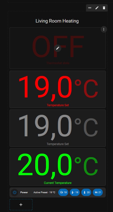

Perfect, I managed to do what I thought I’d do!
Three Big Number Cards:
  • The first (OFF) is displayed only when the heating is off (in summer or when ‘Away’ is active);
  • The second (red temperature) when the boiler is heating;
  • The third (gray temperature) when the boiler is not heating.
Thanks tom for the suggestions.

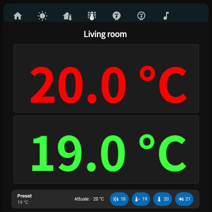

The simplest code:
type: markdown
content: >-
  {{ states(‘sensor.xxx’) }} %
Set your required unit instead of “%”.
Then google how to set styles (color and font size) for Markdown.
