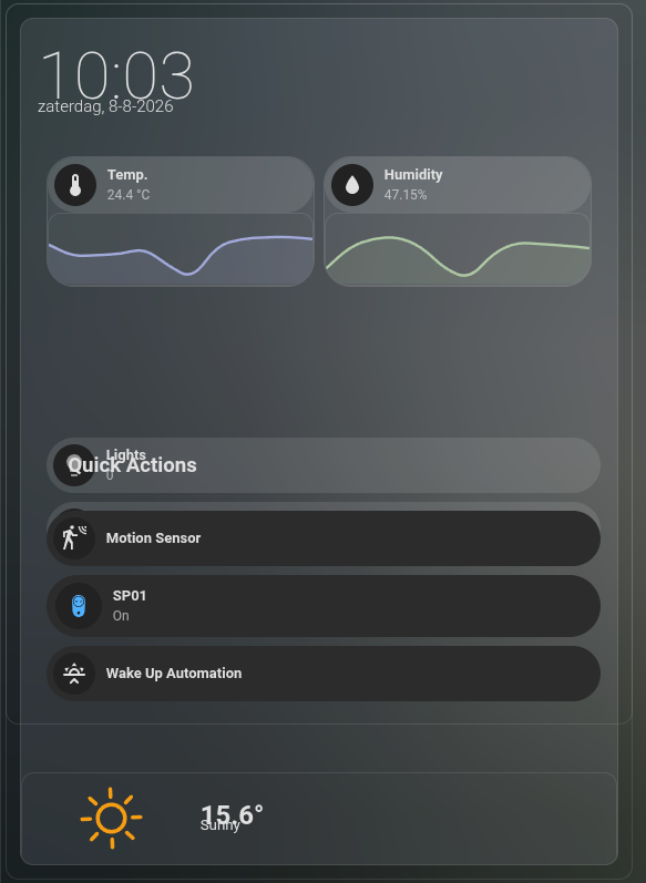

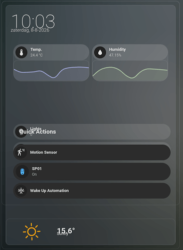

I’m running Home Assistant OS and I’ve found a reproducible issue with my dashboard layout after upgrading Home Assistant Core from 2026.3.0 to 2026.8.x.
What happens
After updating to Core 2026.8.x, the Quick Actions section in my sidebar becomes compressed and all Bubble Cards overlap each other. The rest of the dashboard mostly remains in the correct position, but the sidebar layout is broken.
What I’m using
  • Home Assistant OS 18.2
  • Home Assistant Core 2026.8.x (problem)
  • Home Assistant Core 2026.3.0 (works correctly)
  • Android Home Assistant Companion App
  • custom:vertical-stack-in-card
  • custom:layout-card (v2.4.7)
  • custom:bubble-card
  • custom:button-card
I’m attaching my screenshot of the broken layout.
The issue is limited to the Quick Actions section in the sidebar (the part that contains the Bubble Cards). On Core 2026.3.0 the exact same YAML renders correctly, while on Core 2026.8.x the Bubble Cards in that section overlap each other and the layout becomes compressed.
I’ve already tested:
  • clearing the Android Companion App cache;
  • restarting Home Assistant;
  • checking for HACS updates (none available);
  • modifying the layout-card grid settings;Preformatted text
  • replacing parts of the layout with vertical-stack.
None of these changes made any difference.
Since the exact same dashboard works correctly on 2026.3.0, I suspect a frontend rendering regression introduced somewhere between 2026.3 and 2026.8.
Has anyone seen something similar with vertical-stack-in-card, layout-card, or bubble-card in recent Home Assistant Core versions?
