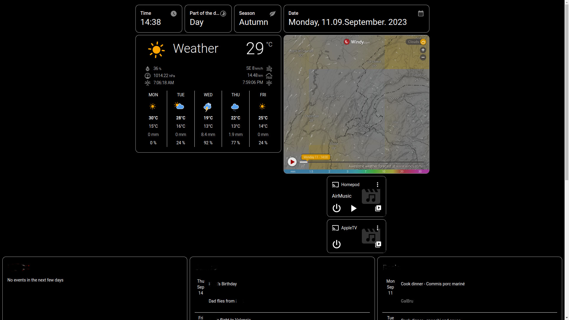

Dashboard layout help - 1080p monitor splitting up row despite having plenty of space
Hello, I have just finished this layout and looks good for me on my workstation, but when I display it on a 1080p monitor it pushes the media players below. I am displaying it on Chromium on a RaspberryPi with kiosk mode active in HASS.
I have tried shrinking the media players with card-mod, and they become small on the 1080p monitor, but they are still pushed below…
Any other advice on my config would be welcome too. Thanks!
What it looks like:
What it should look like:

Dashboards in HA are mobile first - which is to say optimised for a small screen and allowed to adapt to larger displays. This makes it very difficult to lay dashboards out the other way round - design on a large screen and get predictable results on a smaller one.
You could try using panel mode rather than mosaic. This will use the whole width of the screen and give relatively reliable results, but it can only be used with a single card, so everything has to go in a stack or grid.
But basically, they have a life of their own. :grinning_face_with_smiling_eyes:
Can you not put the media control in the same vertical stack as the embedded windy so it should stay below it then.
