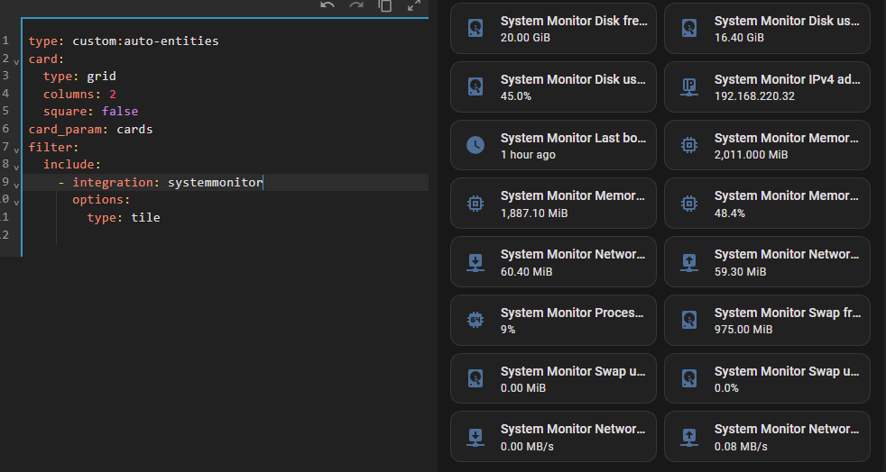

Auto-entities.
type: custom:auto-entities
card:
  type: grid
  columns: 2
  square: false
card_param: cards
filter:
  include:
    - integration: systemmonitor
      options:
        type: tile
