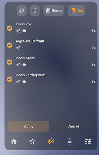

When displaying the order of groups the don’t show up in the order I’ve put them:
entities:
  - media_player.sonos_vardagsrum
  - media_player.sonos_move
  - media_player.kok
  - media_player.hogtalare_badrum
predefinedGroups:
  - name: Sonos
    media: null
    entities:
      - player: media_player.sonos_vardagsrum
      - player: media_player.sonos_move
      - player: media_player.kok
  - name: Alla
    media: ""
    entities:
      - player: media_player.hogtalare_badrum
