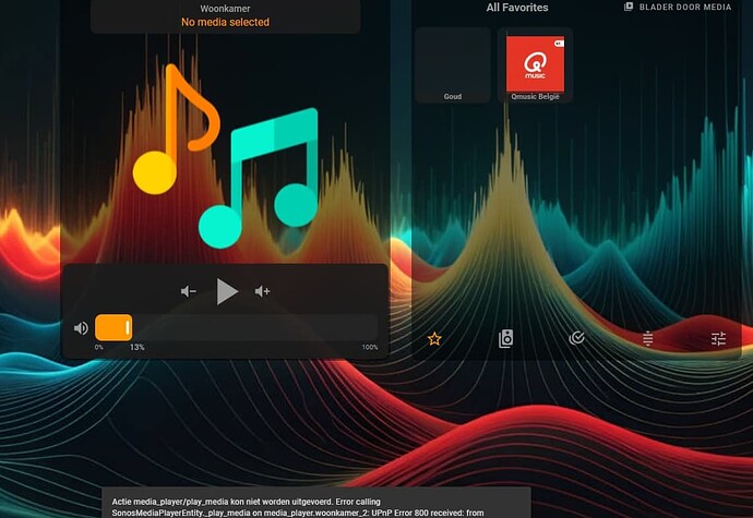

Sometimes when i could not play my favaurites i just added the plex service again to the sonos app and the favourites worked again . Now they appair in de Favourites folder but are grayed out also in home assistant the playlist images dont show anymore .
The problem is the same but the solution is not working anymore .
Anyone having this issue ( i think is on the sonos side of things) if i go to plex true sonos app and navigate the folders i can play anything i want so sonos has acces .
Just not the favourited items .
Is anyone experiencing any issues trying to play spotify playlists? I’m assuming this is an HA/Sonos issue, but every time I attempt to access a Spotify playlist from my favorites I get the following error:
Failed to perform the action media_player/play_media. Error calling SonosMediaPlayerEntity._play_media on media_player.office: UPnP Error 800
So frustrating. Everything else is working fine, just re-authorized Spotify in the Sonos app and get the same error.
Edit: As a followup I checked the sonos integration and was able to play my playlists with no issues, I think it’s something with the way this card is calling the playlist??
Looks like the same issue i am having with plex , seems we are the only ones :- :disappointed:
