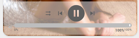

Is there any way I can hide the ā€œ0%ā€ and ā€œ100%ā€ labels under the volume bar?
One of my Sonos player is a Connect that feeds my receiver hence it is on fixed volume level and set to 100% always - then it looks a bit crowded…
Fixed in v9.2.3

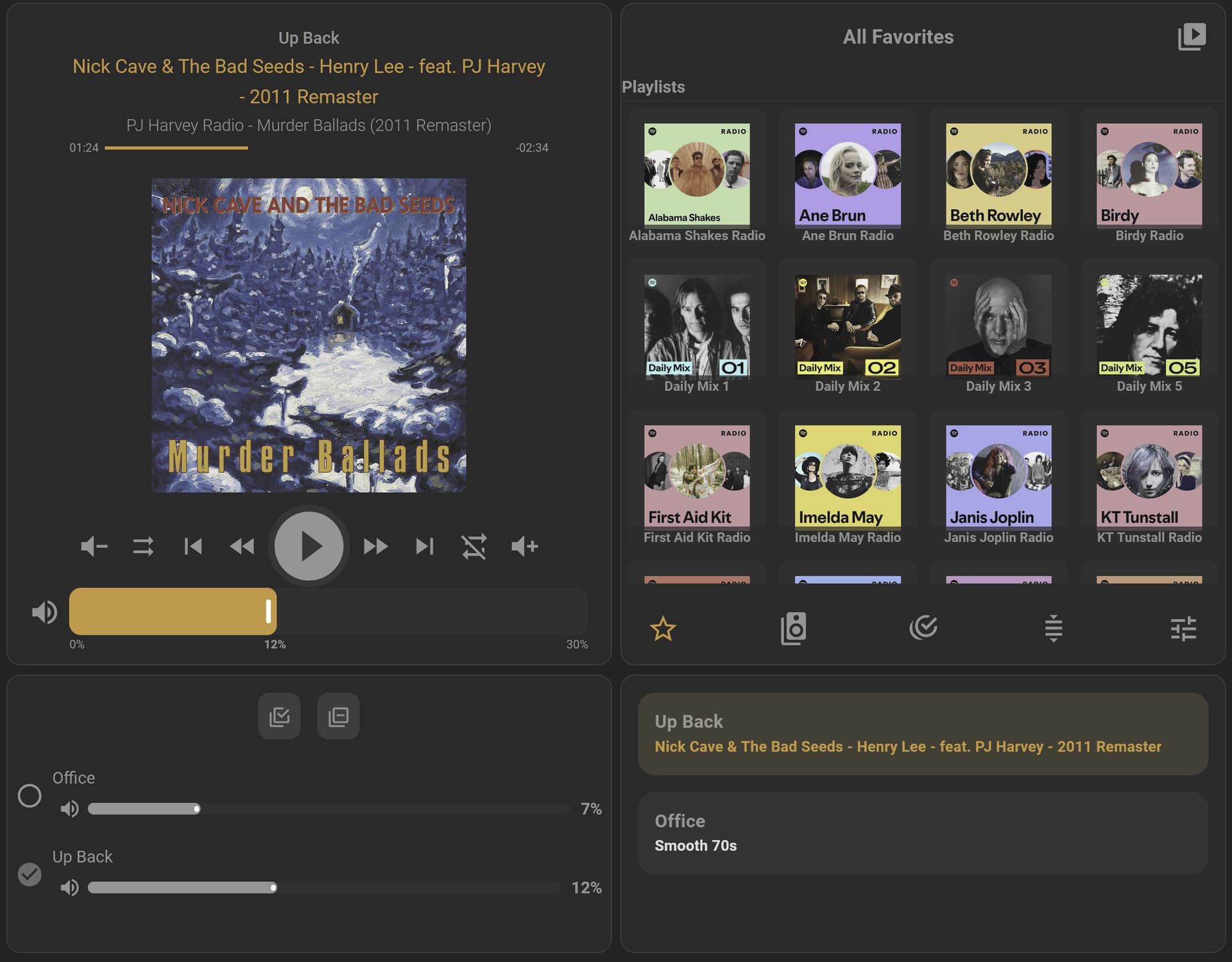

Hi. Got Sonos speakers a few months ago and was delighted to see that I could control them through HA. I think there’s a slight UI aspect that could be improved. The image here is how I’ve setup the cards, but the ā€œGroupingā€ view and the ā€œGroupsā€ view don’t show the speakers in the same order, which bothers me especially when I’m selecting between the speakers, and the other changes but in a different order (badly explained but I hope that’s clear). Any chance that the UI can be changed, or perhaps point me to a configuration where I can do it myself? Thanks in advance.
Thanks for the feedback! I have now made sure the sorting is aligned, try this new release: v9.2.4
Please note that sorting in the grouping section is meant to be aligned with the official Sonos app, which means that members of the currently selected group will be shown at the top.

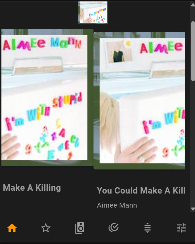

My Sonos card shows the current playing artwork multiple times. How can I fix this?
Home Assistant 2025.10 broke a lot of things…
Sonos Card was updated recently to match that.
So make sure you are on the latest.
Thanks! Updating the card from HACS did work. I didn’t get a notification from HACS that I could update the card this time; strange… but it’s fixt now :slight_smile:
