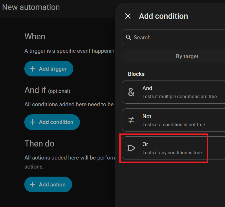

Hi Bob
  1. you can use an editor (official app) to go straight into YAML
    or from the automation, right hand top 3 dots
  2. the OR function is available from the UI
