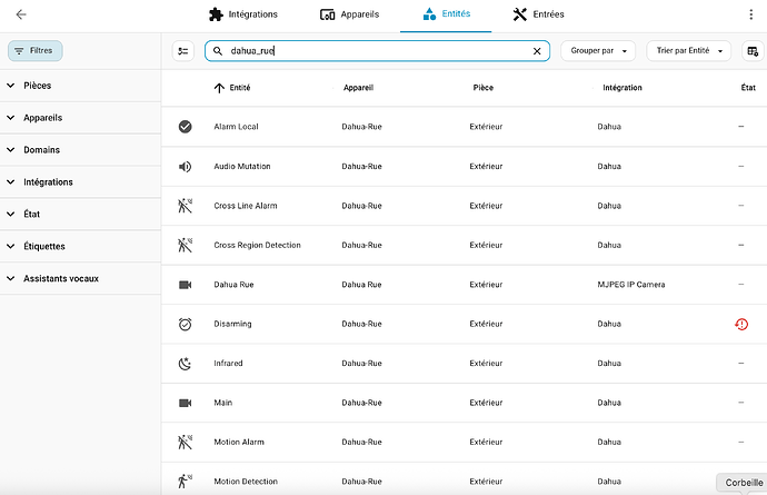

sort by integration, your rue is clealy MJPEG-IP
Your Main might be Generic, Or Dahue as it say
Ip You click at top.right frame/cock-wheel , you can add i.e "entity-id, which sometimes reveals more identification help
And Or click on Devices, where you also can sort on Integration
