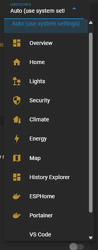

the user has the option to set which dashboard is displayed by default when they log in but that is completely in control of the user themselves. If they want to access every part of HA they can.

I know about the user profile and I share your bemusement at what “system default” means but I’m not sure you’re right about ui-lovelace.yaml because I didn’t have one for a while and everything still worked (I use that word loosely). I wondered if not having one might have been part of the problem and whilst reinstating it did seem to have an effect it didn’t solve anything and it all still feels very random in it’s actions.
I cannot set the default dashboard in my user profile without it always reverting to simply ‘Dashboard’

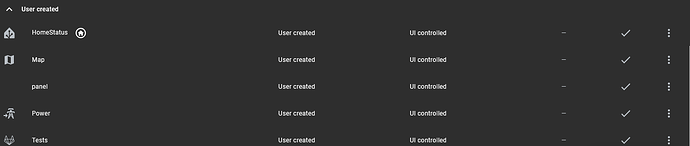

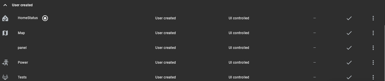

A Picture says more than an essay …or how was now
Anyways, notice the 3 dots to the right, choose what ever Dashboard you want
And as for the “Overview” you can “take Control” and wipe it, use it as a Test-view or whatever, And move it down to the buttom of the left-panel-menu
NOTE: If you click n hold, top-left corner above the left-panel-menu you get a pop-up where you can sort and “Hide Dashboards” in the Menu … im not gonna tell you how, just poke around and you’ll find out

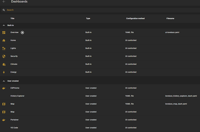

Indeed it does and thank you. Eventually I found this screen. I am not sure whether I have ever seen it before because I tend not to ever need to go to the Settings menu except for Integrations and Add-Ons. I wonder why this is not mentioned anywhere in the docs?
