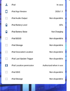

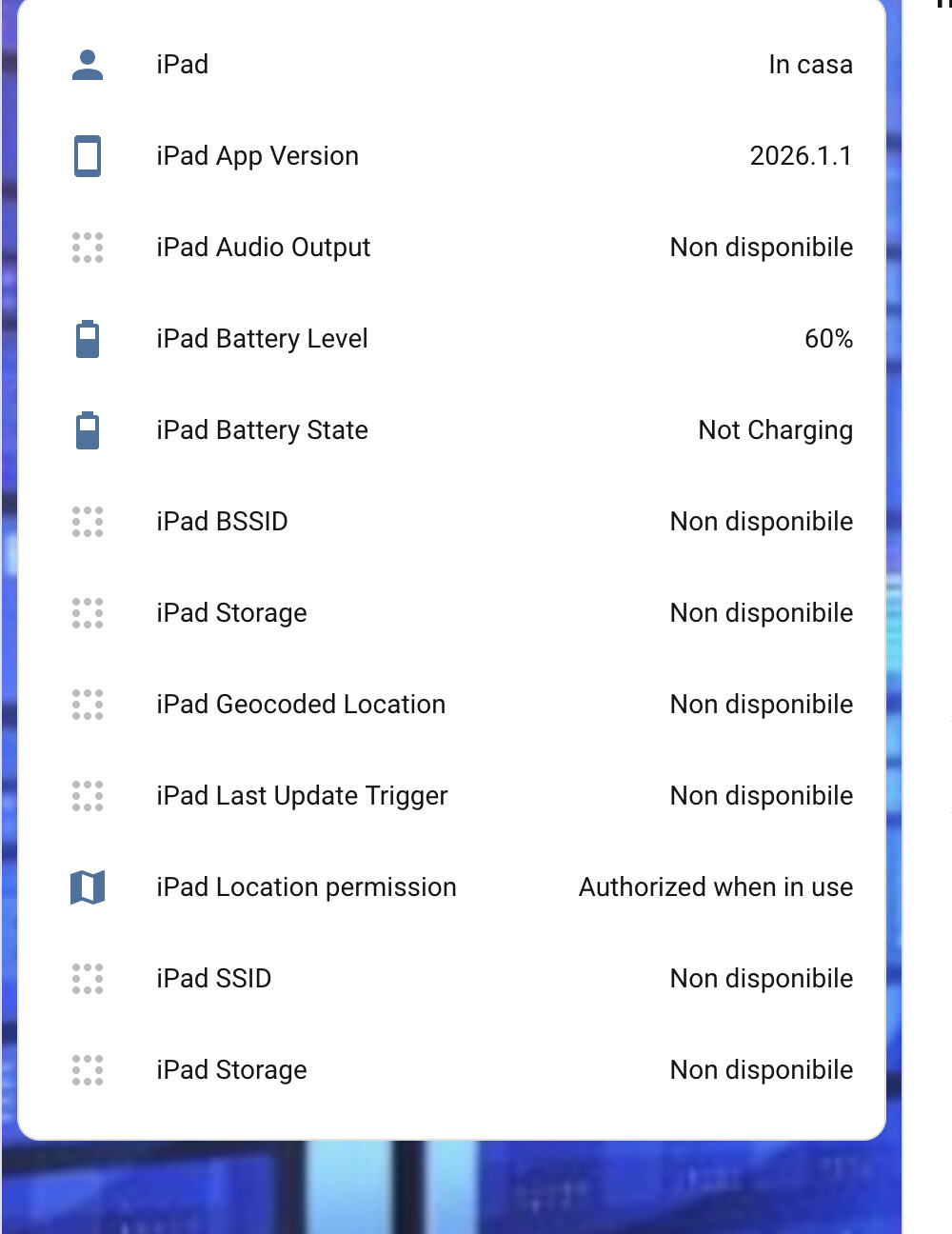

Hello everyone, I installed HA on iphone mac airt , mac mini and ipad .
On ipad the data is incomplete. What can I verify ?
Verify the permissions, both in the HA app and on the device’s own settings.
Both iOS and Android block many sensors related to connection when location permission is not given.
thank you very mich , i m found this permission !
