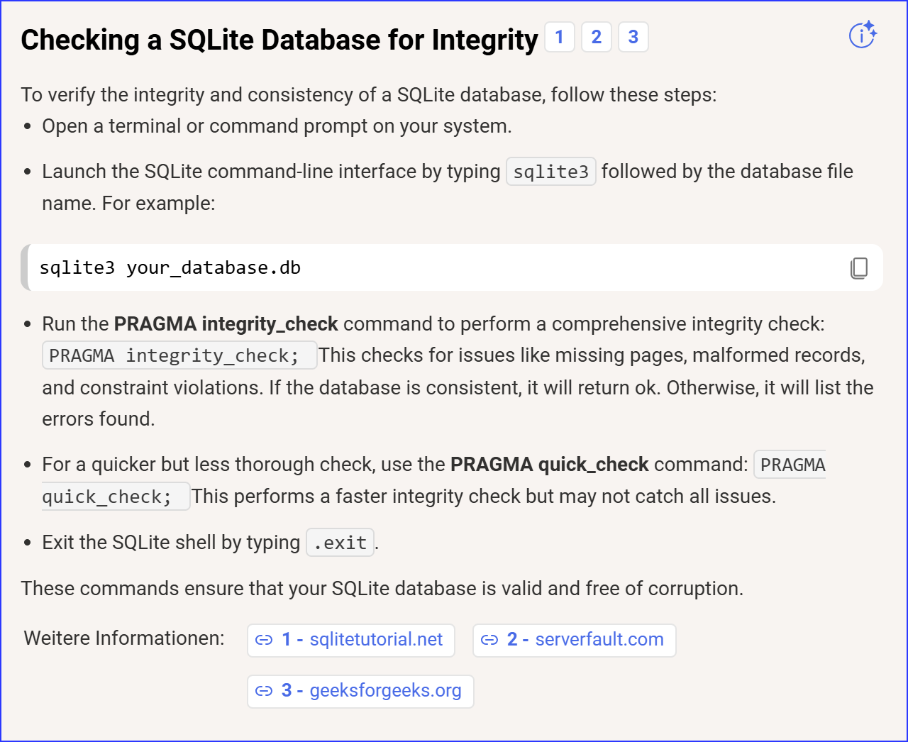

If you are a little bit knowledgeable you could export a copy of the sqlite dabase and analyze it another system. If i’s intact there is a good chance that the issue arises during the purge process.
his scfreenshot describes sqlitge3 which comes with sqlite itself.

For your suggestion for integrity test, it is a little bit above my knowledge skills, but I can try. Is it possible (or advisable) to run on terminal on the HA machine itself?

Learning as I go. I just installed SQLite on windows, download the newly created database from MiniPC to Windows PC and ran the PRAGMA quick_check and integrity_check on it. Both return ok, meaning as from now they are not corrupted.
