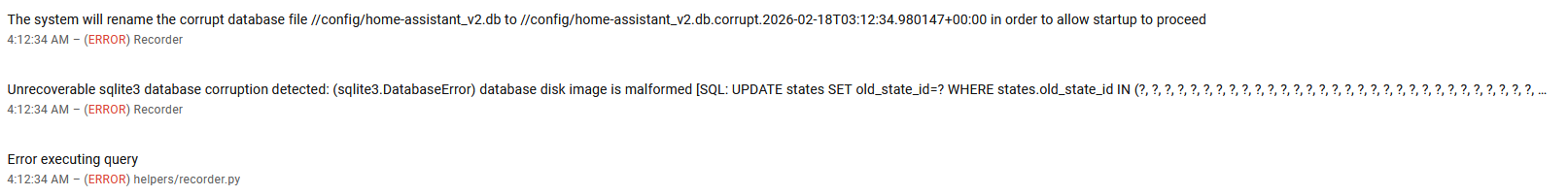

Here are the relevant logs…

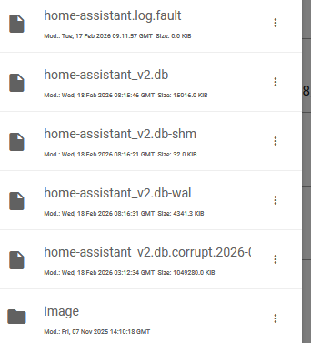

Also, in the config folder i found those db files
seems like your backup already had a corrupted DB. What is the media you store all your config and db on? If it’s SD card, it’s probably time to throw that away.

THe log lines you show, are mentioning irrecoverable sqllite database. Hence it’s trashing the old db and creates a new file and alll your history is unavailable in the new db.
On an SSD this is not so likely to happen and now i’m wondering why it happens. One thing that springs out, is the size of the corrupted DB, is exactly 1GB. And combining that with the momen (purge) it might also be a quota or temp space limit you’re hitting. How big is the file in the backup?
