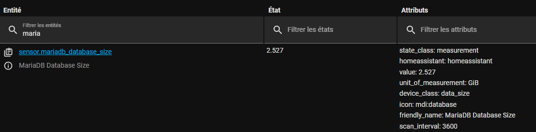

What are the attributes of the device listed in Developer Tools → States (right hand column)?
Here’s the sensor details :
That homeassistant: homeassistant attribute is odd. It should be database: homeassistant.
Also that is not how you define a custom scan interval. This is: SQL - Home Assistant
I agree. Don’t know where the homeassistant attribute comes from …

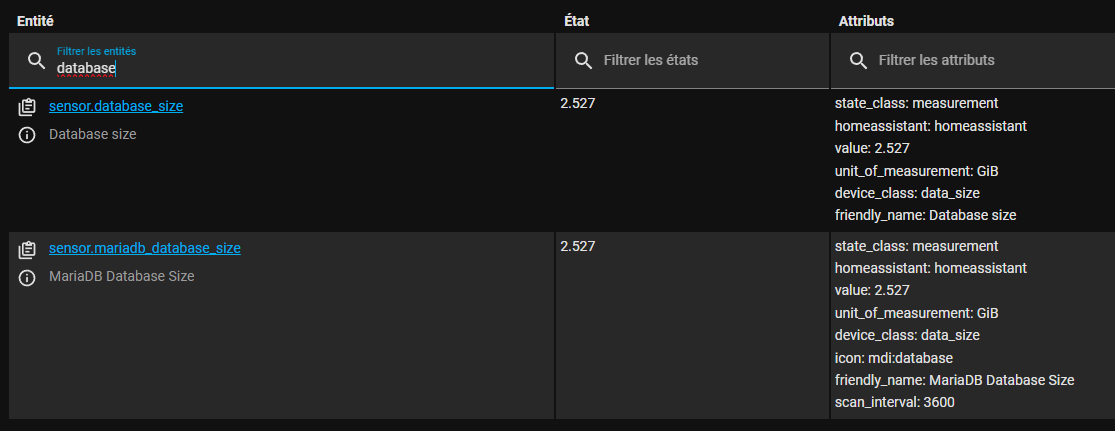

I created a new sensor with the SQL integration UI, and not from a YAML file, and it also creates that attribute :
SQL integration creates an attribute for each column in the output. From what I can see, you can just remove table_schema "homeassistant", from the select command as it is not needed for anything anyway.
Edit: or rename it to “database”: SELECT table_schema "database", Round...
You’re right. I wasn’t paying attention at the SQL request itself (and the GROUP BY is no longer necessary).
SELECT Round(Sum(data_length + index_length) / POWER(1024,3), 3) 'value' FROM information_schema.tables WHERE table_schema='homeassistant';
Now the sensors are “clean”. Let’s see if this will change something with the long term history. Wait and see…
