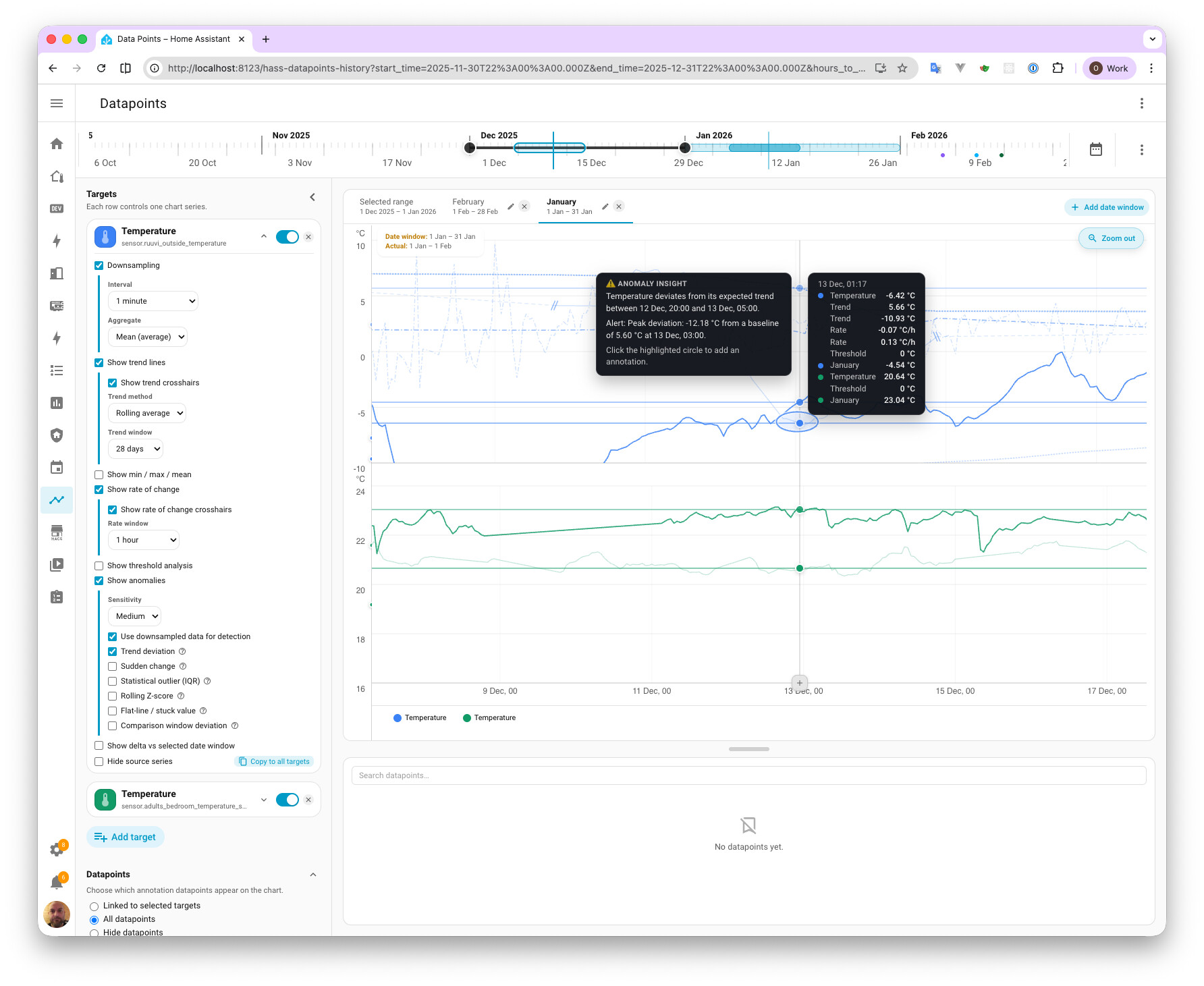

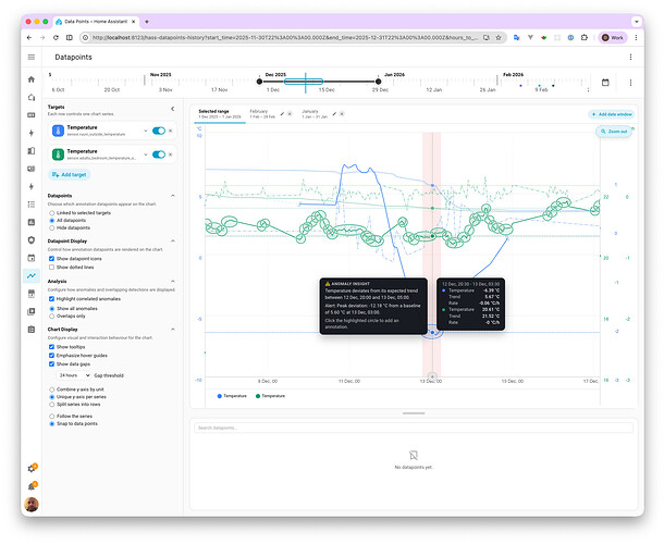

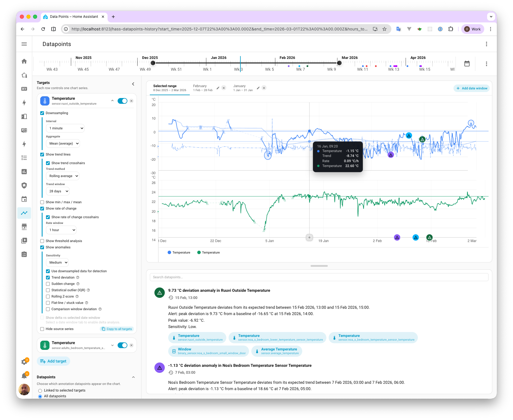

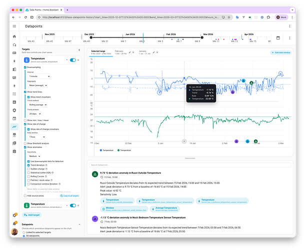

Data Points is an attempt to address that. It lets you record timestamped events (notes, labels, icons) and overlays them directly onto your history charts, so you can actually see what was happening at the time rather than just the raw values.
There’s also a per-entity analysis layer built into the history view. Things like trend lines, summary stat bands, rate-of-change overlays, and a set of anomaly detection methods (Z-score, IQR, residuals, flatline detection, spikes, comparison windows). You can also overlay different time periods for the same sensor to compare behaviour, and there’s a sidebar panel for browsing and editing recorded events.
