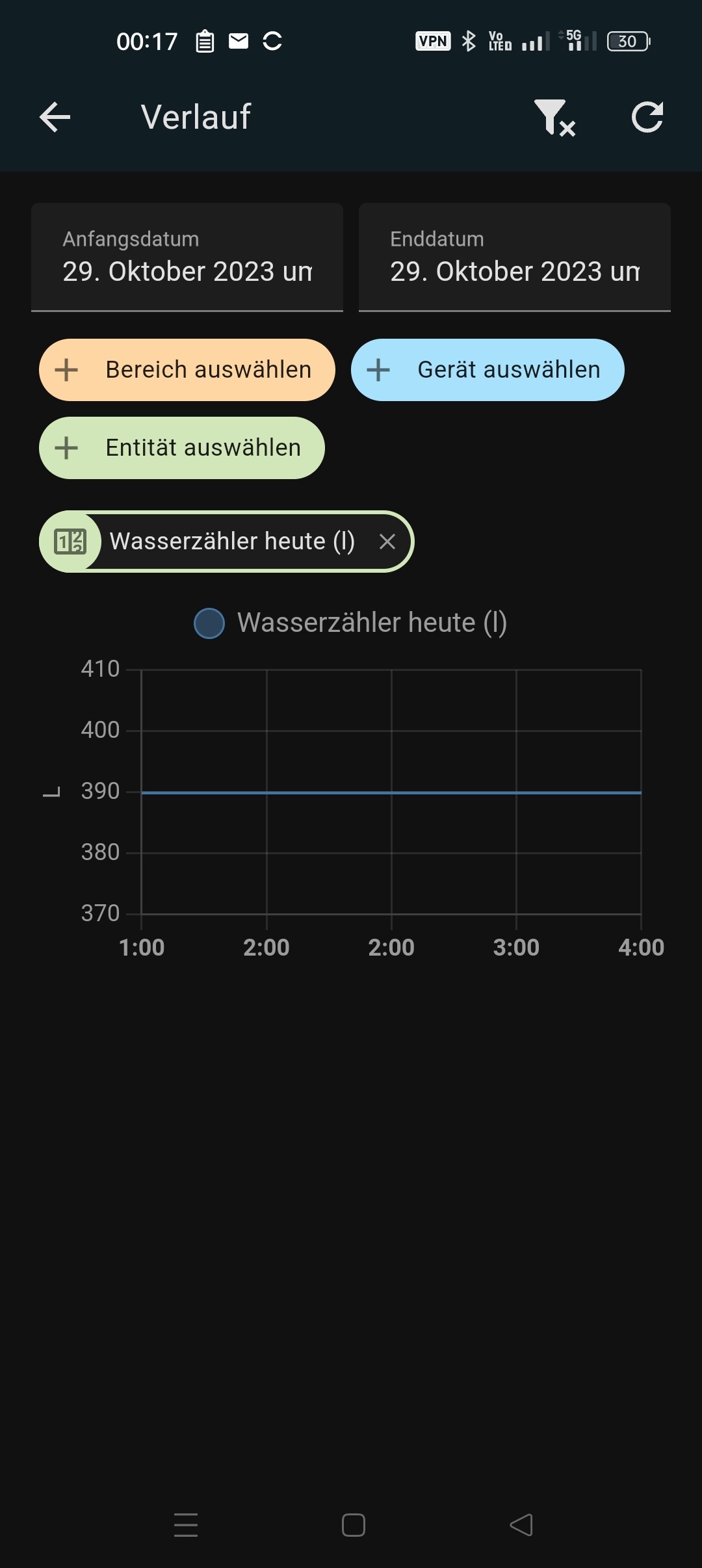

Hm, this is the time of the time change in my system - located in Zurich.
