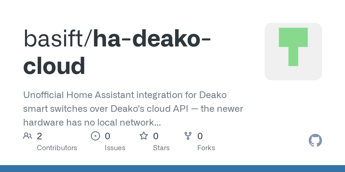

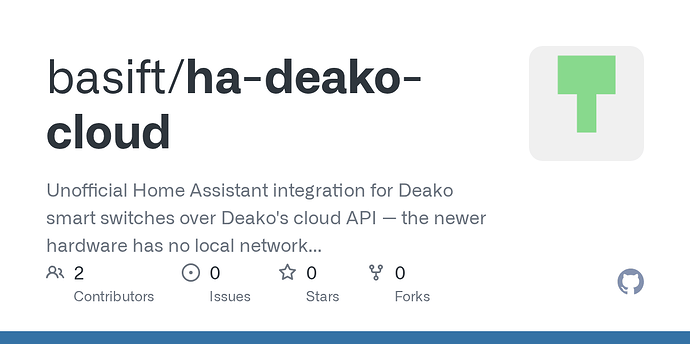

So my good friend Claude and I (sorry, ex-friend Google) did some reverse engineering and built a fresh Home Assistant integration:
Long story short
Older Deako switches listen on port 23, so Home Assistant can communicate with them directly.
It doesn’t work particularly well, but at least it works somehow.
Newer Deako switches don’t expose any ports at all, so there is no way to talk to them directly over the local network.
That’s why I reverse-engineered the communication used by the Deako Android app and built an integration that talks directly to the Deako cloud.
