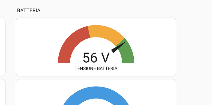

Hi everyone, I just updated to the latest version and I realized that the battery voltage reading doesn’t give me the decimals ex. 56.45 etc. I attach the esp32 code and image.

I restored a backup this is a screenshot of the old version …

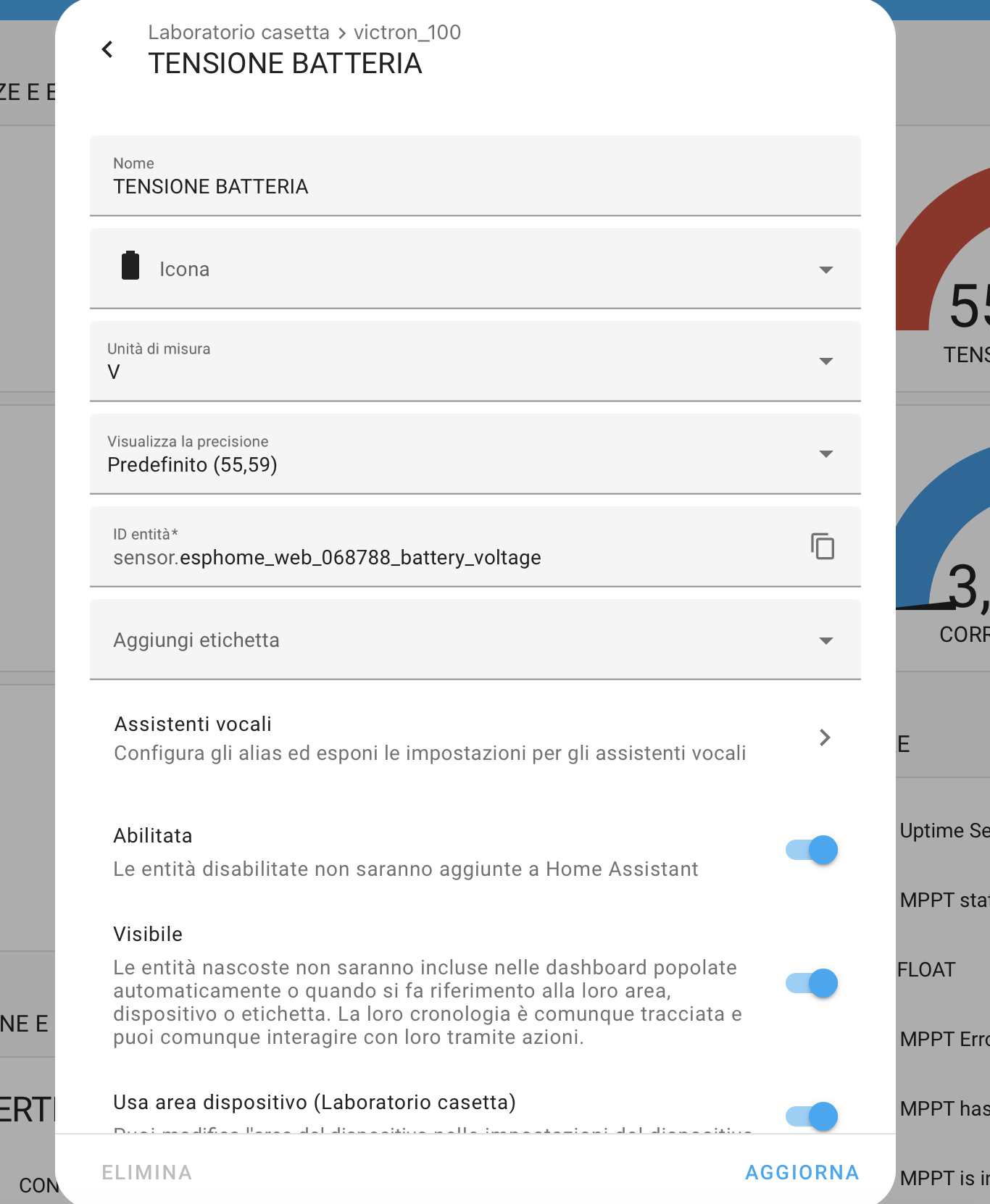

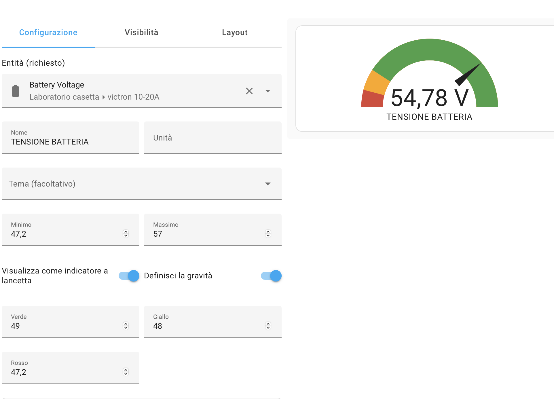

Hi, I had the wrong card I think it’s this one.
So it seems HA is getting the correct value with 2 decimals.
What does the Gauge Card config say?

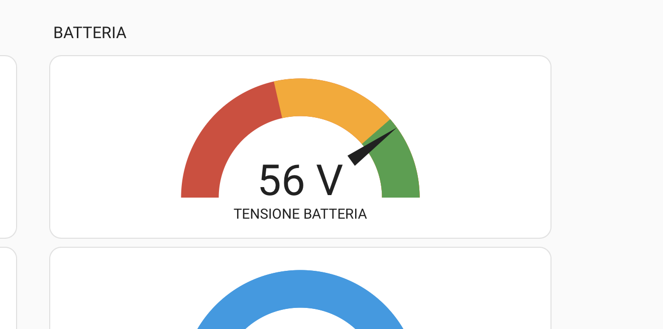

I have the same problem. Many of my energy sensors were suddenly showing 0 decimal point after the most recent updates. I can still go and change this in the sensor configuration but I never had to do this after an update.
Same here 2025.6.0 seems to set the display precision of all voltage sensors to 0 decimal places.
After upgrade, my LIFEPO4 Cells values are shown without decimals in Home Assistant but if I use node-red to show me the values, it show me exactly the values what I get in JK-BMS app. Hopefully the next Home Assistant Update will fix this.
This one solves the issues. Thanks.
What solved it, ha 2025.6.1 also have voltages with 0 decimals as default, has there been made an issue on this to devs?
Rather not want to change all entities with voltages to manually use more decimals.
Should be default as it has always been.
