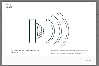

At the DeConz Dashboard i start the pairing mode for new sensors:
After this i pressed the pairing button on the sensor for a few seconds till it starts to flash blue.
After ~2 sec the flashing stops and the led lights up continuously for ~3 seconds. then the led will turns off.
There is no successfully paired message and the Dashboard will not show the new sensor.
