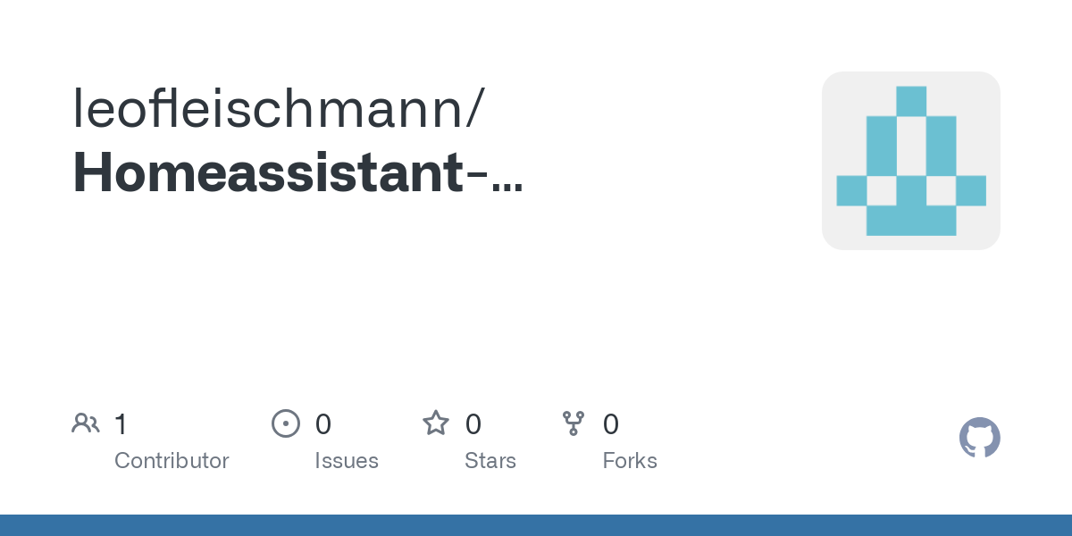

I saw this today and somehow managed to get it working by adapting code from here:
It’s not perfect yet, but it’s working for now :slightly_smiling_face:
Just add this to your custom repositories in HACS and configure it:
Maybe a good starting point for further development!
