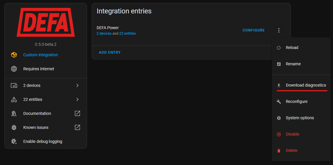

I just released version 0.5.0 beta 2.
This version
  • fixes start/stop charging actions not working
  • adds entities for eco mode settings (including per weekday departure time not available in the app)
  • Download integration diagnostics including anonymized API responses
This version should also skip creating entities for things missing in API responses and start/stop charging buttons should be available if charging state in unavailable to improve eRange compability.
Can someone with a eRange charger try this version and post at least the api_responses part of the diagnostics? It should be anonymized but might be good to double check.
Sorry, thought I had notifications on new posts, but apparently not. Here’s my full diagnostics (had to manually anonymize done parts under token):

What eRange model do you have?
Does all the entities that have not been skipped (charging_state and ampere) seem to work?
get_load_balancer, get_network_configuration and get_max_current_alternatives all seem to fail for you, I guess it is not possible to change max current or network settings in the app on eRange chargers. You are able to do that on DEFA Power chargers.
Here is my diagnostics (DEFA Power 22kw):

I think it’s this one: https://www.defa.com/content/uploads/Documentation/EV-Charging/Base-stations/Product-sheets/712759-eRange-IQ-Facility-14kW-22kW-RCCB-2480217.pdf
Charging state and ampere limit are unavailable.
