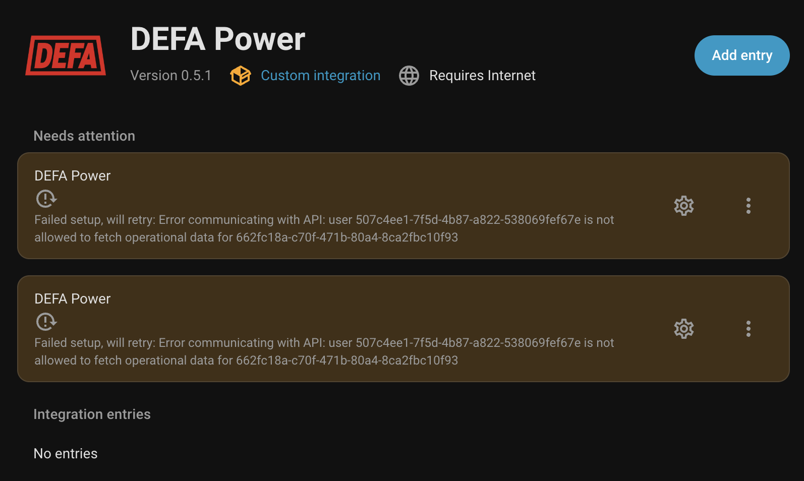

It’s not going great for me…
I don’t know if anyone have tried to use this integration with a charger with multiple connectors before so that might be the problem or it is something else causing it.

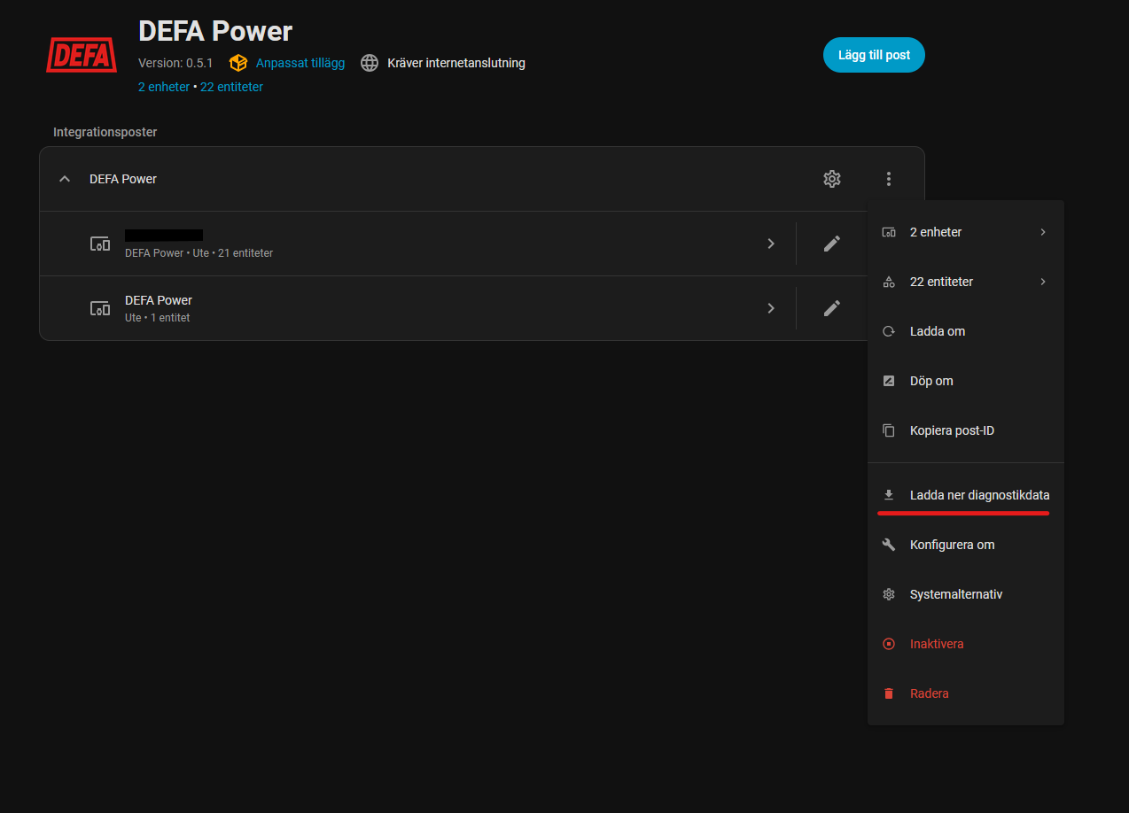

Are you able to download the diagnostics data and post it?
