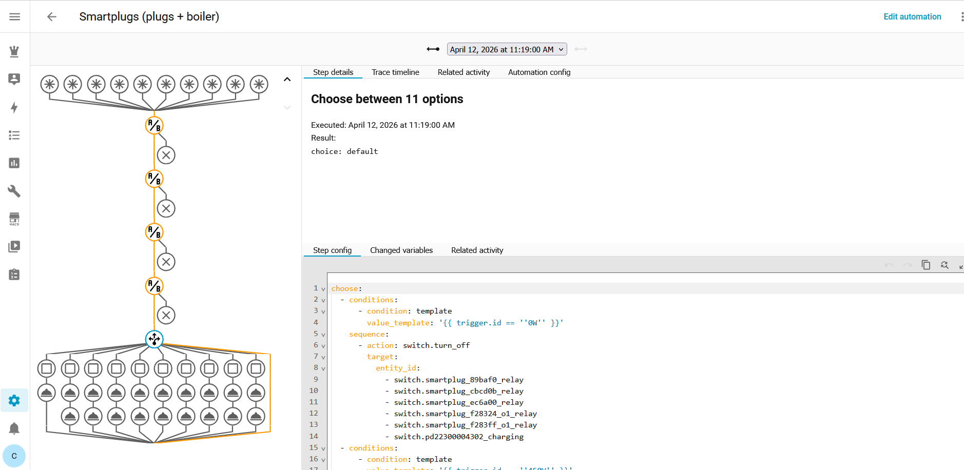

At the moment of activation the sensor.solar_netto_produced has a value of 1000W. Nonetheless I see that it just follows the default path as if it doesn’t meet any template conditions (which it should because there are actions defined for this in trigger id ‘900W’
The strange thing is that when I wait some time, lets say 10 minutes it does work. This gives me the impression that the triggering of the automation through another (30 second time triggered) automation does not necessarily work and it just gets triggered by its own conditions when there is a trigger (for example in this code, when the power exceeds 900W and triggers the 900-1200W portion of the trigger.

If you manually run an automation then none of the triggers have fired, so there is no trigger id to test for. You can see no trigger fired in the trace graph.
It is advised against manually triggering automations and bypassing triggers, partly because of this reason. Actions you want to run without automation triggering is what scripts are for. You’d best use numeric state conditions in the choose instead of tests for a trigger.
ps. there is a dedicated condition for testing trigger ids. no need to use a template for it.
