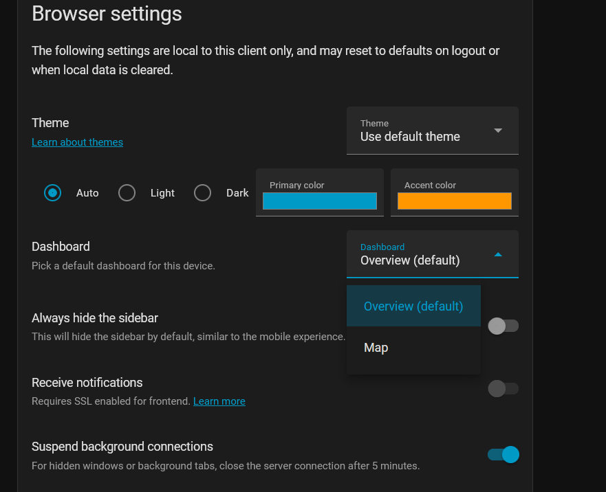

You can select which dashboard you want to show as a default for the tablet/user in the profile settings of the app or a browser, but (without major trickery) it will always default to the first view of the dashboard.
Create a dashboard with your customized view in the first/left-most position and set it as the default dashboard in the ‘Browser Settings’ of the profile section of that user on the app.
I cannot select a view there?

You can only see the dashboards.
That’s why I suggested to create a new dashboard and add your customized tablet view to it - keep it in the leftmost place if you’re adding new views to it.
Then pick the new dashboard from the dropdown.
