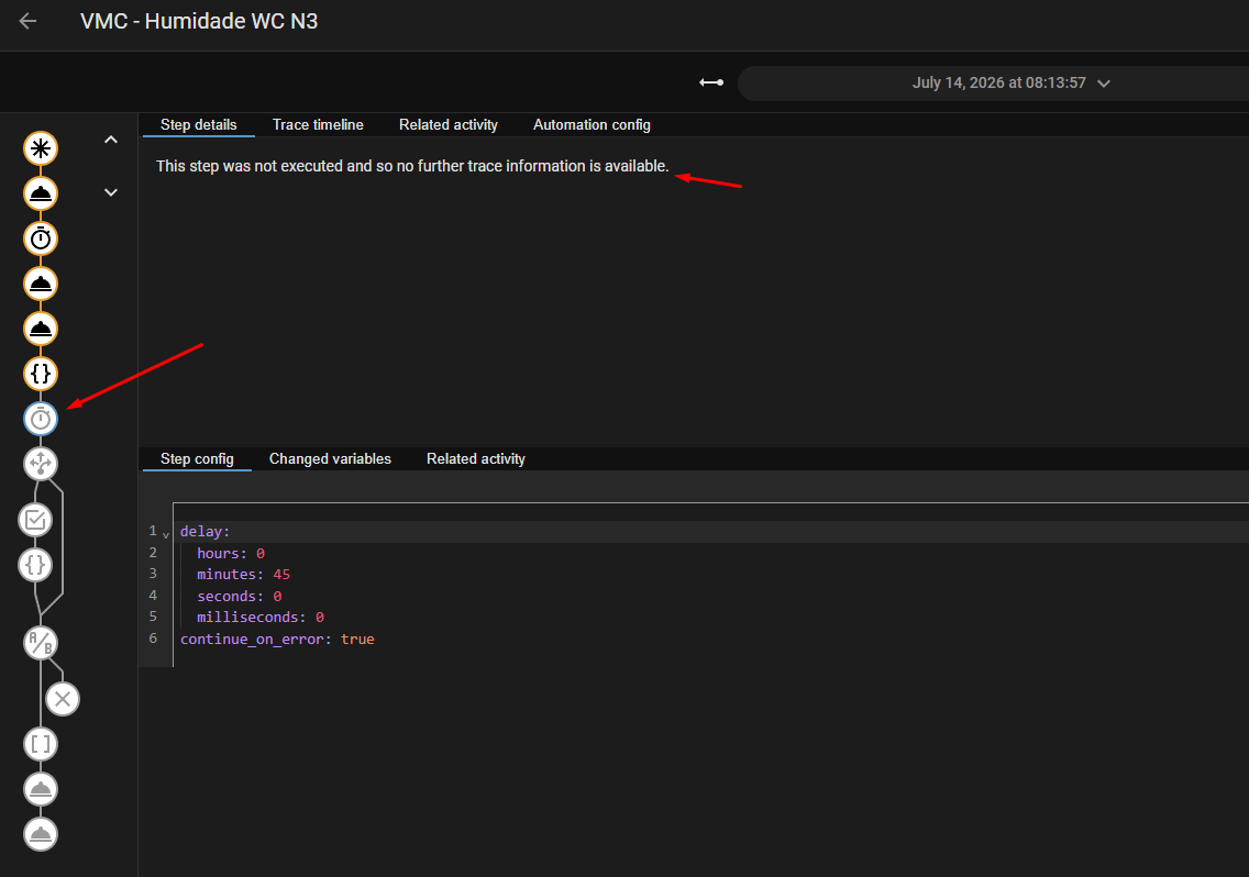

For some time now I’ve been noticing that some of my automations are not behaving as expected due to the ‘Delay’ action. Has anyone else been experiencing this issue?
Is this a known problem?
Thanks

Additional context STOP a running automation (NOT TurnOff)
But this automation worked for years, and now is giving me problems.

Is this an action?
Yes, is to change the mode of the VMC to “heat”.
Why do you think the error is with the Delay action?
Do you have any traces that show the delay being the problem?
Because that action was not executed.
That is because of this:

Why the issue with the Delay action is in the Mode state?
