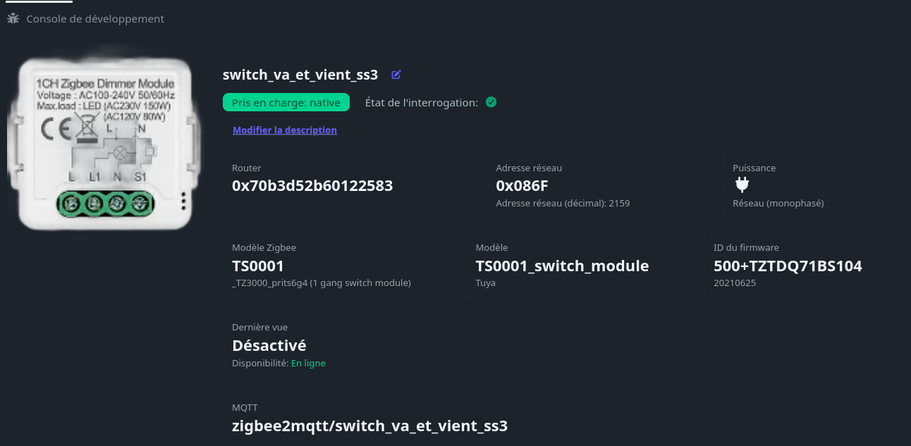

I am experiencing problems using different zigbee gang switch modules
These modules, two way switch, are working fine without HA.
As soon as these modules are paired inside HA using zigbeeMQTT, all is working well, except when I turn on the light, sometime it’s instantaneous, sometime It can take until 30 seconds before switch, sometime just after switch on it toggle switch off and it’s necessary to switch it again.
Most of time if I switch from HA dashboard it’s instantaneous and steady.
I thought it was the module that failed, but I tried 3 different brands and the behavior is the same.
The configuration is set as :
    "countdown": 0,
    "indicator_mode": "on",
    "linkquality": 255,
    "power_on_behavior": "off",
    "state": "OFF",
    "switch_type": "toggle"
Did I miss something in configuration ?
It switchs one led bulb and one neon tube

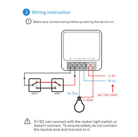

My wiring is this one:
