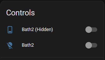

The original is a “switch” that with the help of a helper is now a light.
switch.bath2 → light.bath2
Just saw your update so the light and the bulb are actually just the same switch ?
nope. That is the only automation for that switch. Previous one is deleted.
Let me disable all other automations, not that I have something stupid somewhere. Gimme a few minutes.
The issue here is that the switch and the light are coupled. The automation I gave you assumes that they are independent (switching the bulb doesn’t affect the switch).
If the bulb is really just a helper pointing to the same place, it will cause issues.
I only see two ways to solve this:
  • If the switch has a “decoupled” mode so the switch locally, does nothing without Home Assistant online (then the script above will work as is).
  • Otherwise we are going to need to rework it (but there will be some limitations).
back to no switching off :joy:
gimme a sec to fix that.

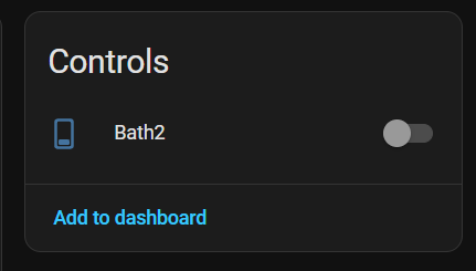

removed the light. now is only a switch
Now I just saw your question.
Yes the switch is the only unit turning on/off the light. To make it appear as a light on the dashboard I created the helper.
There is only one device. this one

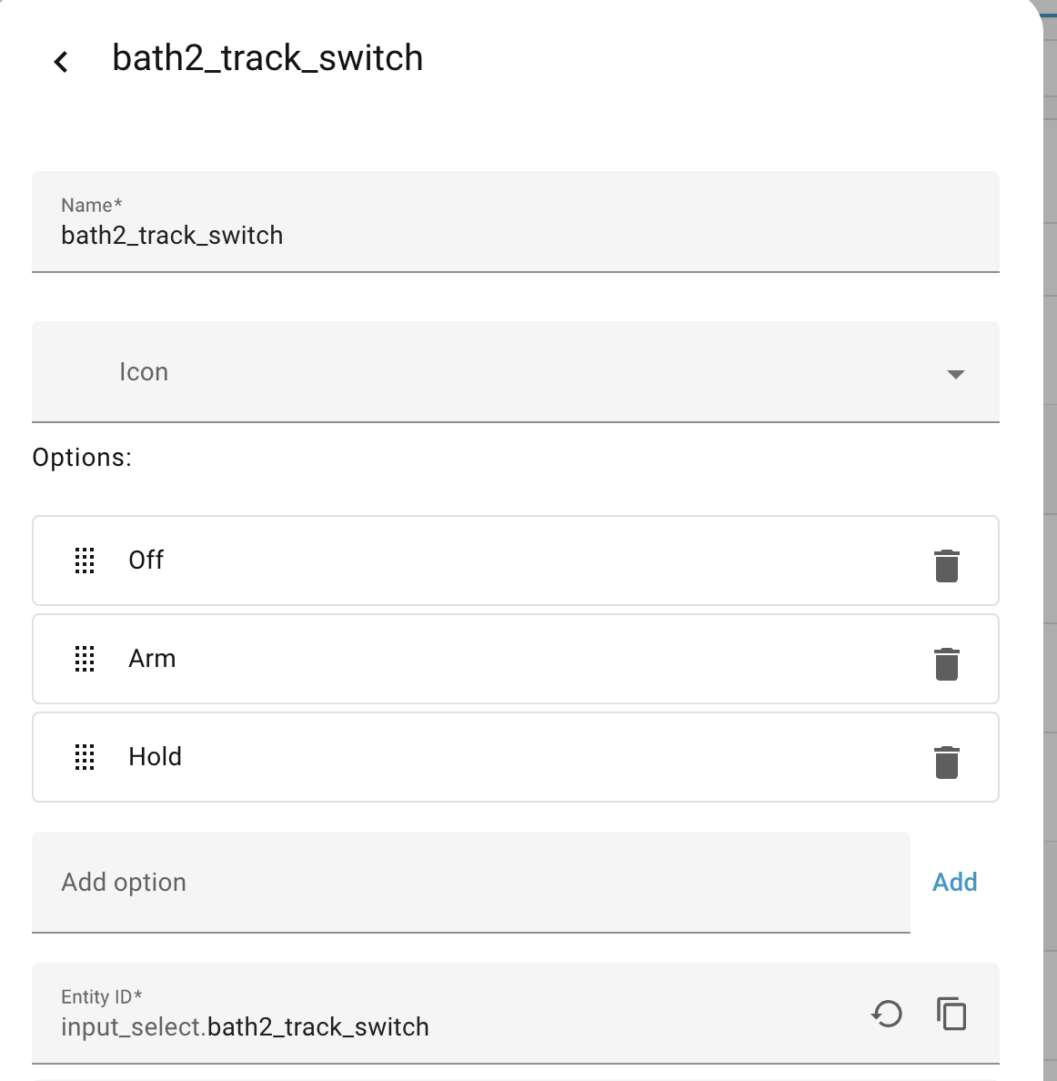

First I created an additional dropdown helper with three states: Off, Arm, Hold
Then I modified the automation to:

The first trigger condition “Arms” the hold if the binary sensor triggers (just changes the select to “Arm”).
The second condition is triggered if the light is turned Off AND the hold is Arm(ed), in which case it will run the final sequence to turn the light back on wait 5 minutes then turn it off again.
