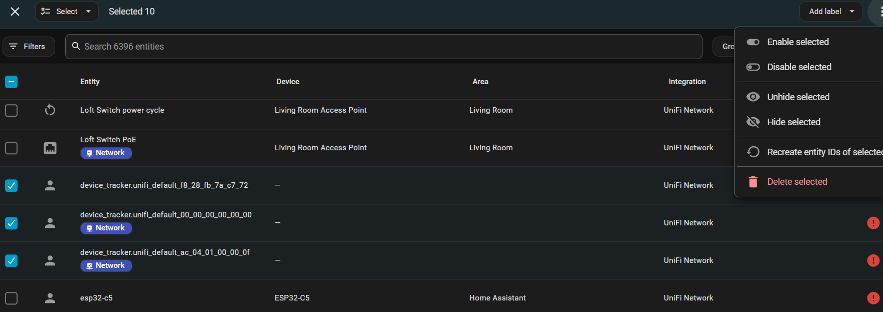

In the entities page, sort by status and then scroll to the ones with red !
Then click on (shift click works for multiple rows and then click on delete in top right (3 dots)
If they are able to be deleted, they will be
Use the filter on the top left to only show "Not Provided" Status entities. Then select them all.

Thanks, that is a very practical way. But only for the "not provided" which were about 40 in my case.
I remain with so many "not activated" entities that I cannot delete. What do I do with those? Or just carry on not worrying about them?

There is integration Orphan Entity Cleaner.
Great, thanks! I will give it a go.

You don't delete undeletable entities, you disable them.
Yes, I agree.
Works like a charm.Thanks! THis should be a core functionality.
