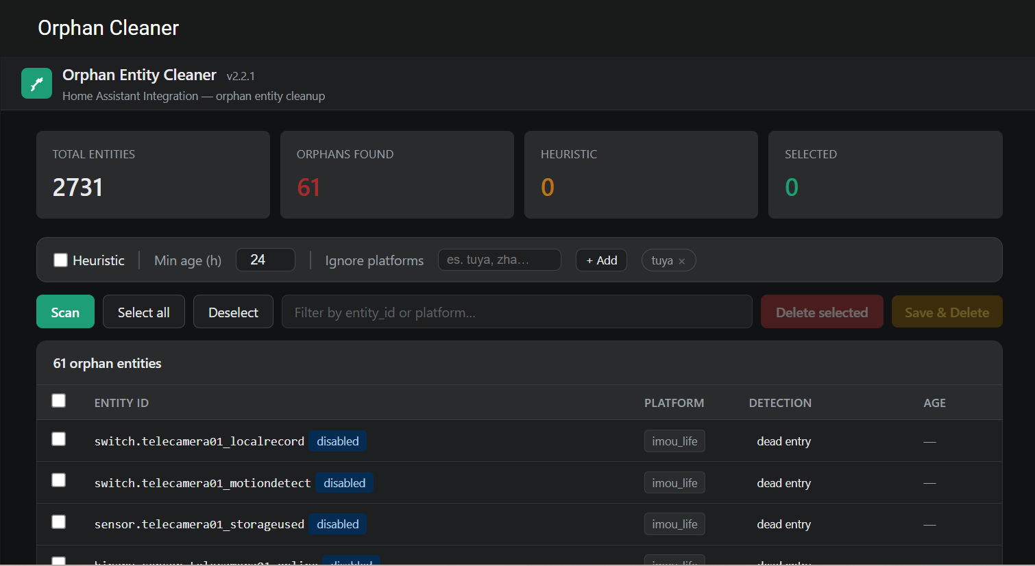

After installation, the Orphan Cleaner icon (:broom:) appears in the HA sidebar.
The panel allows you to:
  • Scan the registry with one click
  • Filter results by entity_id or platform
  • Select entities individually or all at once
  • Delete with a confirmation dialog
  • View the operation log in real time

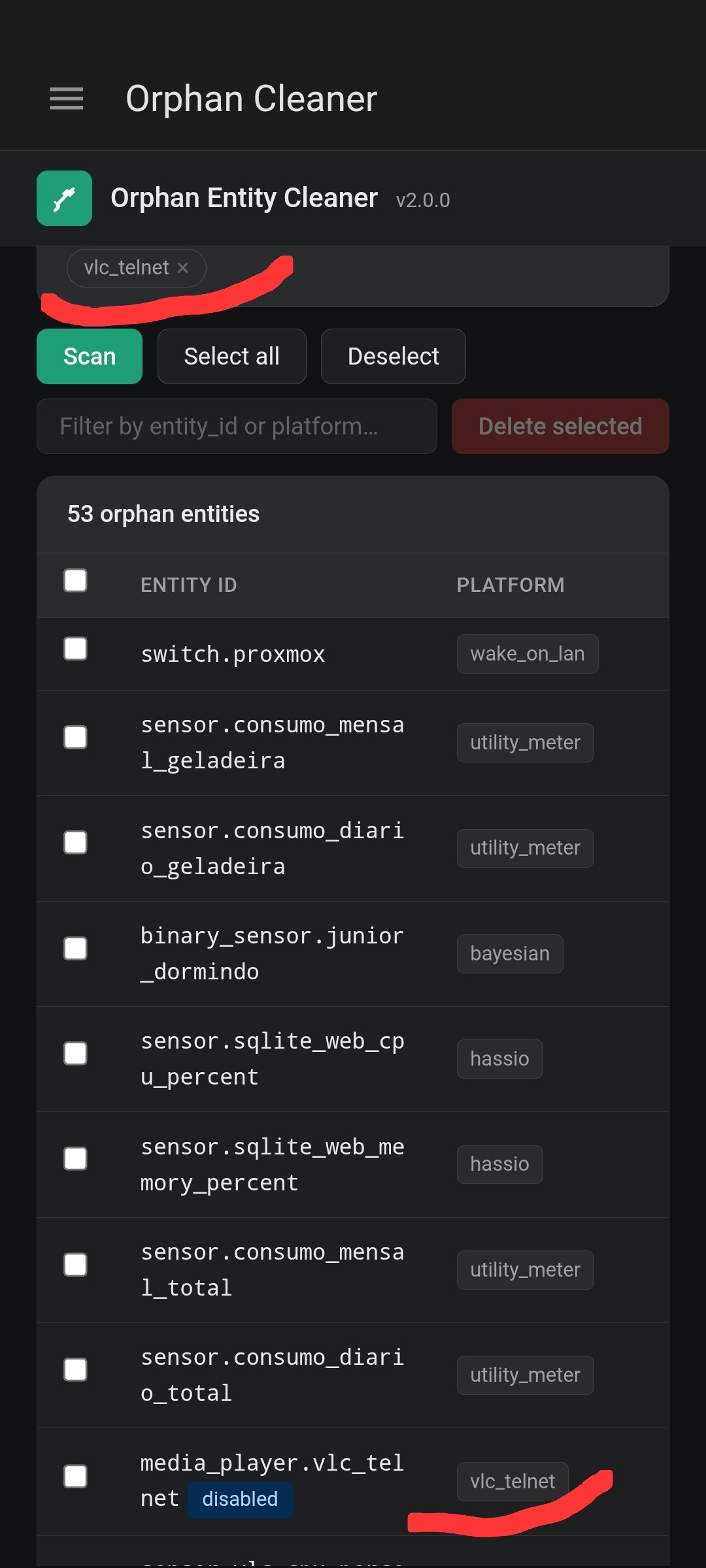

Nice.
But it seems the “ignore platform” option isn’t working correctly.
Suggestion
If this is so important then why not provide this option?
Fixed in v.2.1.0
Well. It’s a lot difficult but I can try to implement this in a new release.
Done. New feature. Enjoy it!
