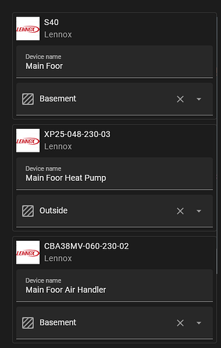

I added a new integration from an HACS install, and everything was fine, however I noted that I accidentally gave it a name prefix of “Main Foor” instead of “Main Floor”, and all the entities were using “*.main_foor_…”.
No big deal I thought, just delete the device, it deletes all its entities, and then I add it again. I do that, type in the correct name, but then notice that the entities are all being created still with “*.main_foor…”. When I do the Update Entity IDs option, it only updates a handful of all of the associated entities, and the only way for me to actually fix the others is to change them manually. Likewise, if I am doing a search for the entities, they still show up under the incorrect entity ID, presumably because that is the original name, as shown in the core.entity_registry file.

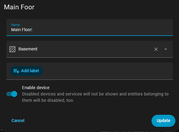

Entity_ids (and other user settings) are now retained even if you delete the integration, device, or entity. Just rename the device and regenerate the entity_ids from the 3 dot menu on the device.

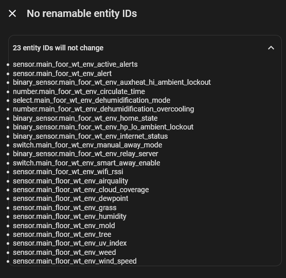

This does not work. I noted in my original post, but out of approximately 30 entities, it says it will only be updating the entity_ids for a handful of them. All the others retain the original, incorrect entity_id, unless I manually rename it, at which point it still has references to the old, incorrect entity_id and name within the core.entity_registry.

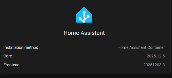

Are you running an old version of HA? The current versions will alter all entity_ids without skipping any when you regenerate entity_id’s from the 3 dot menu.
Negative
Negative.
name it back to Main Foor WT ENV, regenerate the entity_ids, then rename it Main Floor and generate again.

To clarify, the system is simple and you can abuse it. All it does is look for common slugified device names and replaces those values. So those others weren’t changed because they didn’t have main_floor and they didn’t change originally because they had main_foor_wt_env

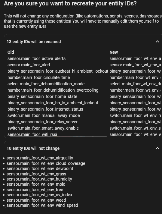

Interestingly, now it is holding on to the old Main Foor WT ENV name if I recreate the device instead of the Main Foor name, but still won’t hold on to Main Floor :melting_face:

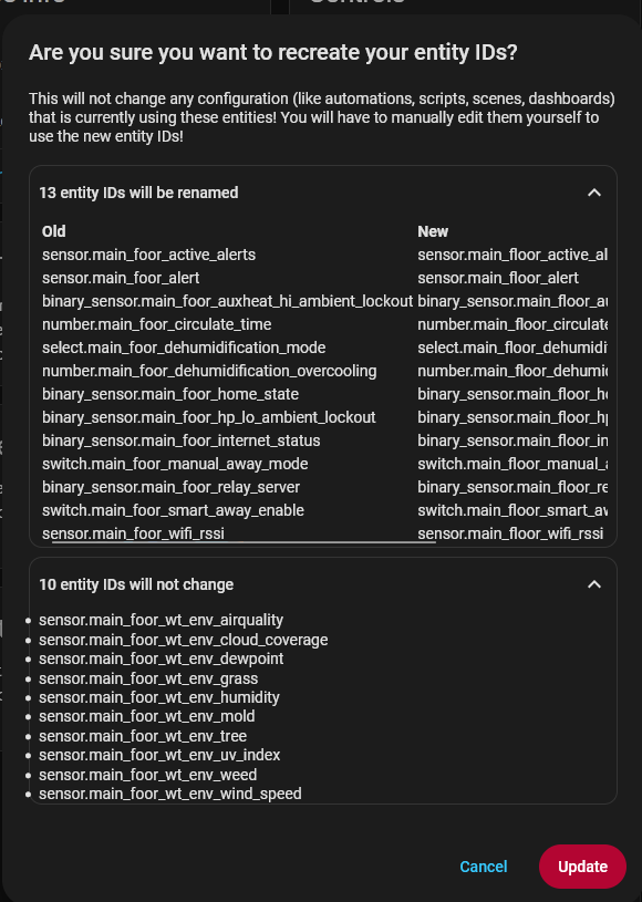

well I see some main_floor_wts in there for those old _wt entities. What’s the exact process you followed?
Renamed to Main Foor WT ENV, did the regenerate entity ids (but did not confirm), canceled out, deleted the device, restarted HA, added the device again, saw that it now was being given a default name of Main Foor WT ENV instead of Main Foor, clicked the regenerate entity ids, got the above popup. I had at one point manually renamed all the main_foor_wt_env_* entities to main_floor_wt_env_*, but noted that the old main_foor_wt_env_* name was still present in the core.entity_registry file, so deleted everything to try and figure out how to get it creating everything “properly” instead of me having to juggle entity ids.
